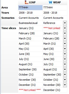

    I have experienced a problem when linking LEAP and WEAP, that is, the time slice can not be linked properly.
    In the linkage interface in LEAP, LEAP does not allow me to link LEAP January to WEAP January, and that results in LEAP February being linked to WEAP January; LEAP March being linked to WEAP February; LEAP April being linked to WEAP March; so far so on; in the end, no month is linked with LEAP January, neither WEAP December, as shown in the picture attached below.
    On the WEAP side linkage interface, the linkage works appropriately.
    Can you please help me with the problem? I am using LEAP version 2020.1.0.55 (32-Bit) and WEAP version 2021.01.
    Thanks
    Xin

    Hi Xin,
    I can confirm this is due to a bug in LEAP. I am working on a fix for it and hope to post a new version of LEAP that fixes the problem quite soon.
    Apologies for any inconvenience.
