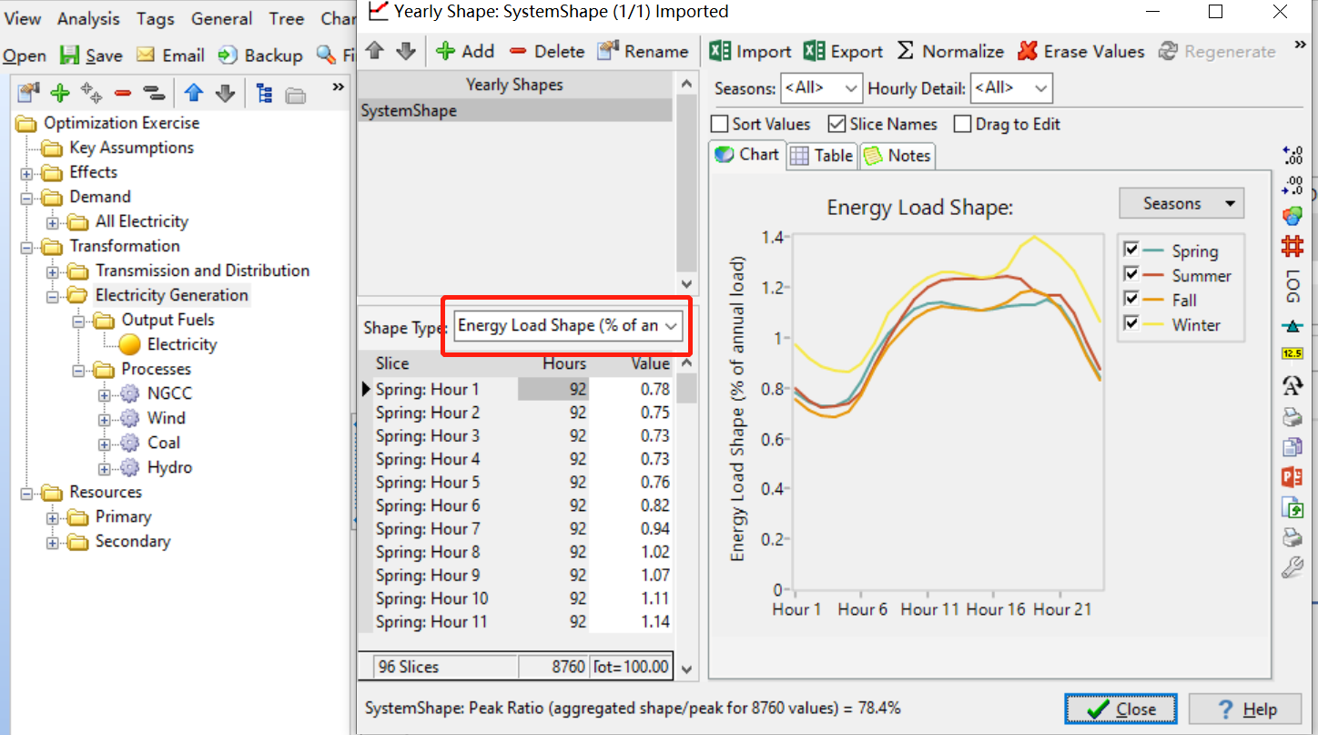

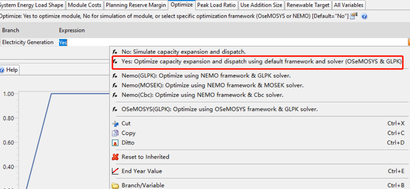

  • Liya Cai 2/28/2022
    Hi John,
    We you do the optimization, the most important thing is setting the Yearly Shape and select the Energy Load Shape. Meanwhile, select Yes in the tab of Optimize. Hope this helps.
