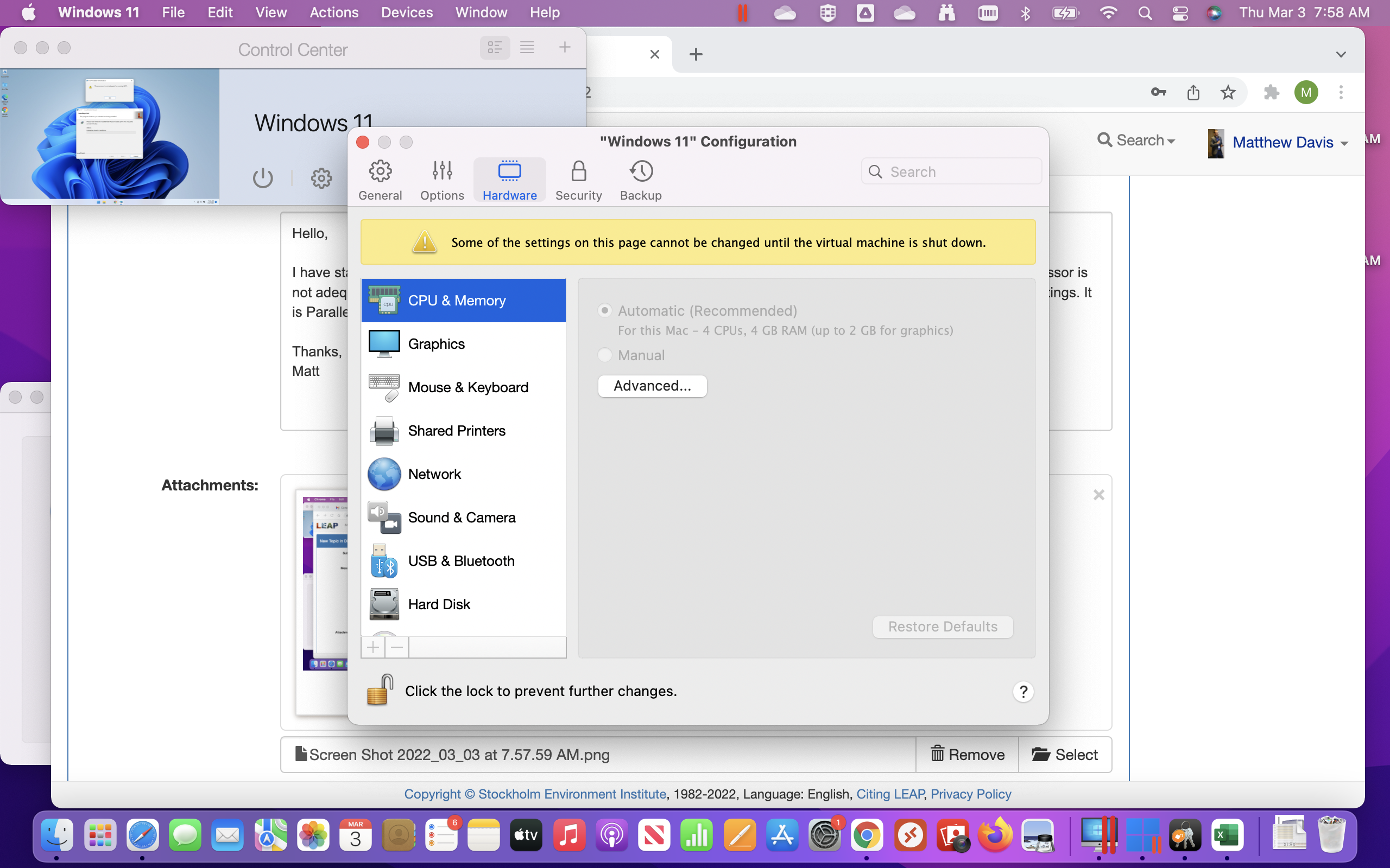

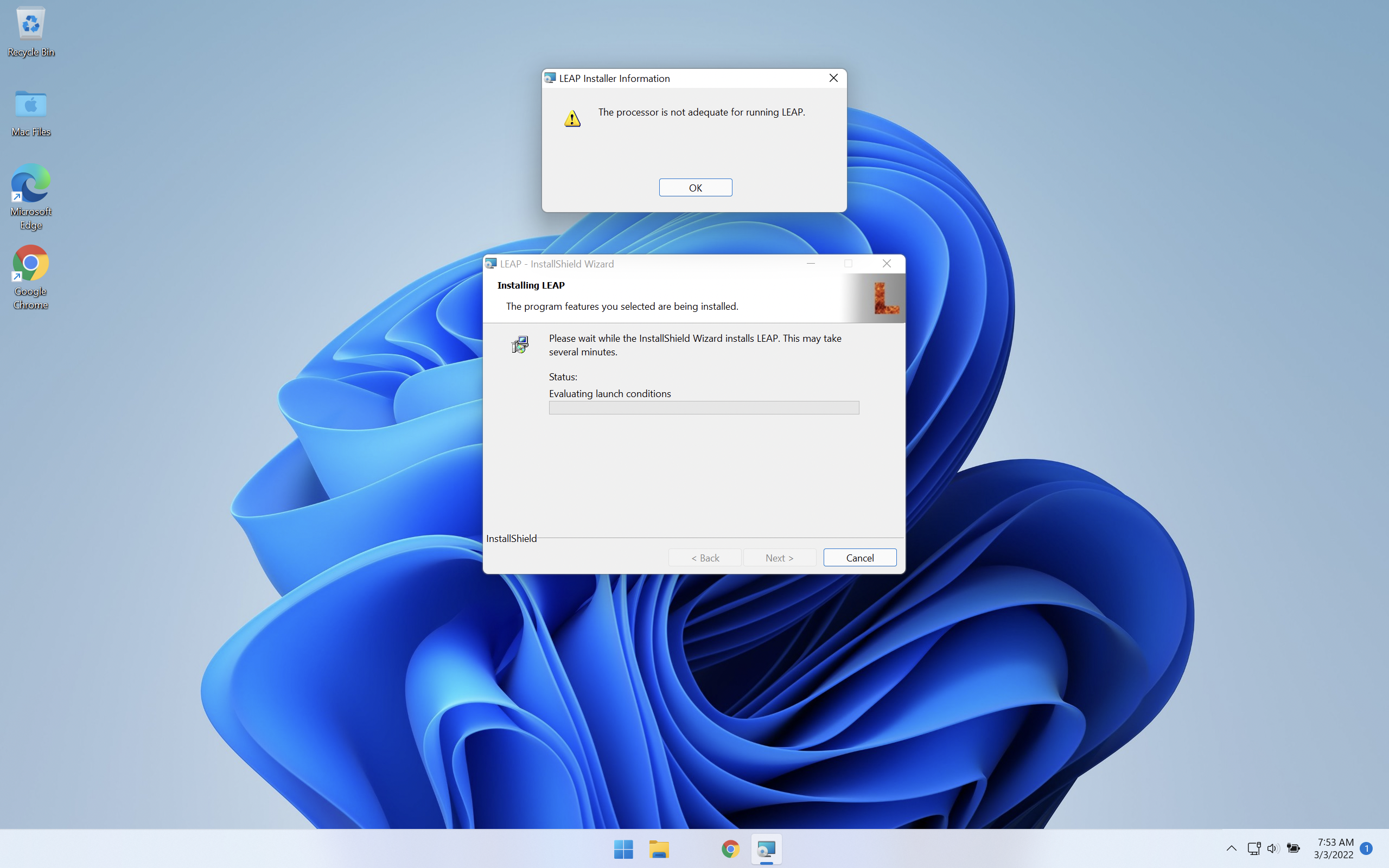

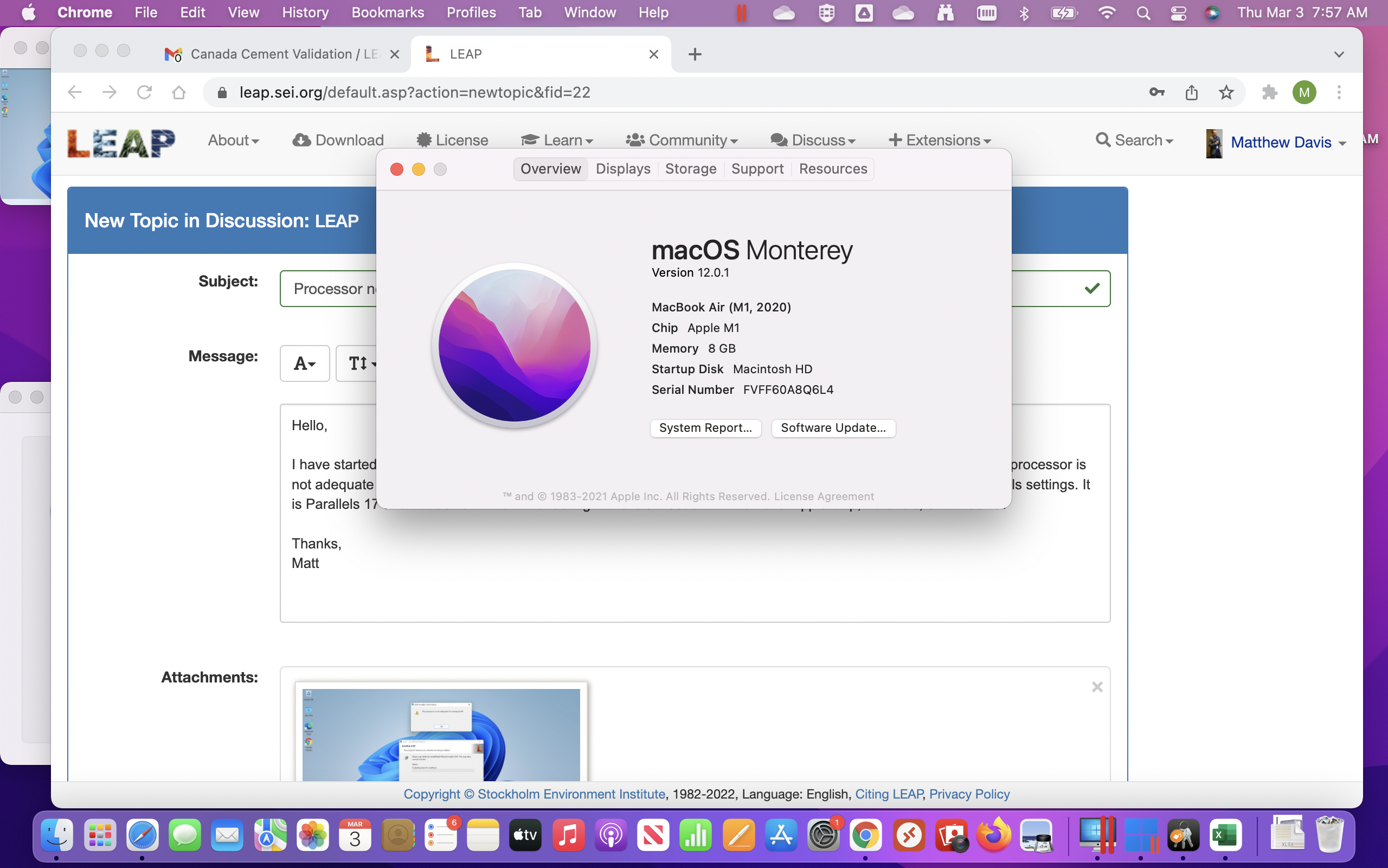

    I have started using Parallels Desktop on my MacBook (Apple M1 chip) and when I install LEAP I get an error "The processor is not adequate for running LEAP." I have attached a screen shot of the error, also my MacBook specs and the Parallels hardware settings. I am using Parallels 17 and Windows 11. I am wondering if this is an issue with the novel Apple chip, Parallels, or Windows?

    I have tested LEAP on Windows 11, but NOT on the ARM version of Windows 11 as I don't (yet) have access to an M1 Mac. It would be great if you could help me with this.
    I had a quick look at the InstallShield settings for the LEAP setup program, and I see it is checking to make sure there is an Intel Pentium or higher chip. So if that restriction were simply removed, I think there is a decent chance this would work fine on the ARM version of Windows. I can create that for the next release of LEAP. Would you mind testing it for me when ready?
  • Charlie Heaps 3/21/2022
    I’ve made some tweaks to the installation routines in LEAP v2020.1.57, which hopefully will allow for installation. Please let me know once you’ve tested it. Thanks!
