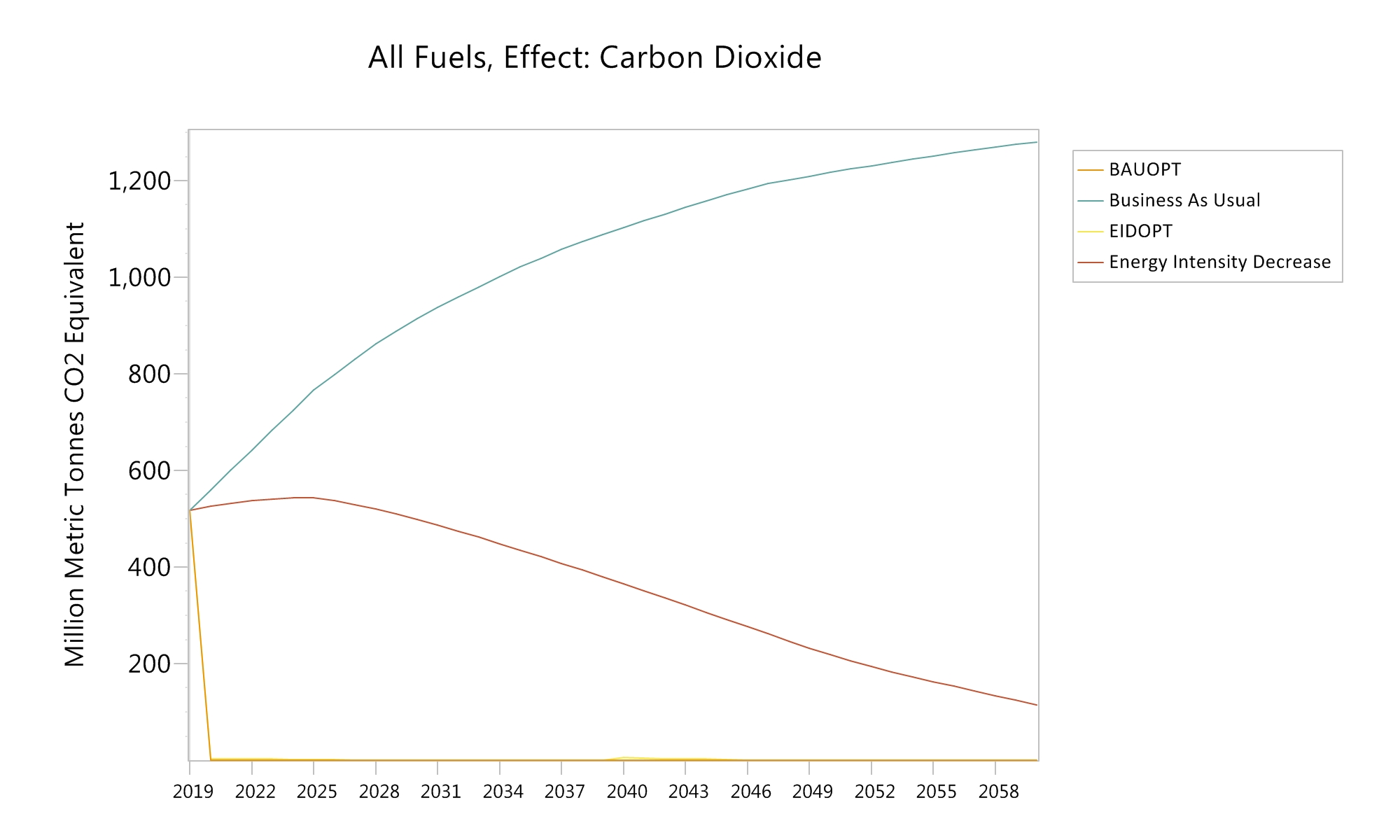

    I have accepted your advice and added parameters about the natural gas power plant. I set four scenarios: BAU, BAUOPT, EID, EIDOPT. I have run the results and found some questions. The attachments are the LEAP files and the parameters of LEAP-YRD.
    Firstly, why the transformation branch only has electricity plant emissionThe heating branch also consume some fossil fuel.
    Secondly, why the electricity plant branch only has the emission of coal progress? Other progress also comsumes fossil fuel, such as natural gas.
    Thirdly, why the optimization of BAU and EID cause the zero emission of transformation branch? Is the optimized passway all non-fossil fuel power plants?
    Best Regards!

    LEAP 2020.1.57 includes a few bug fixes that should help alleviate the dispatch problem you noted.
