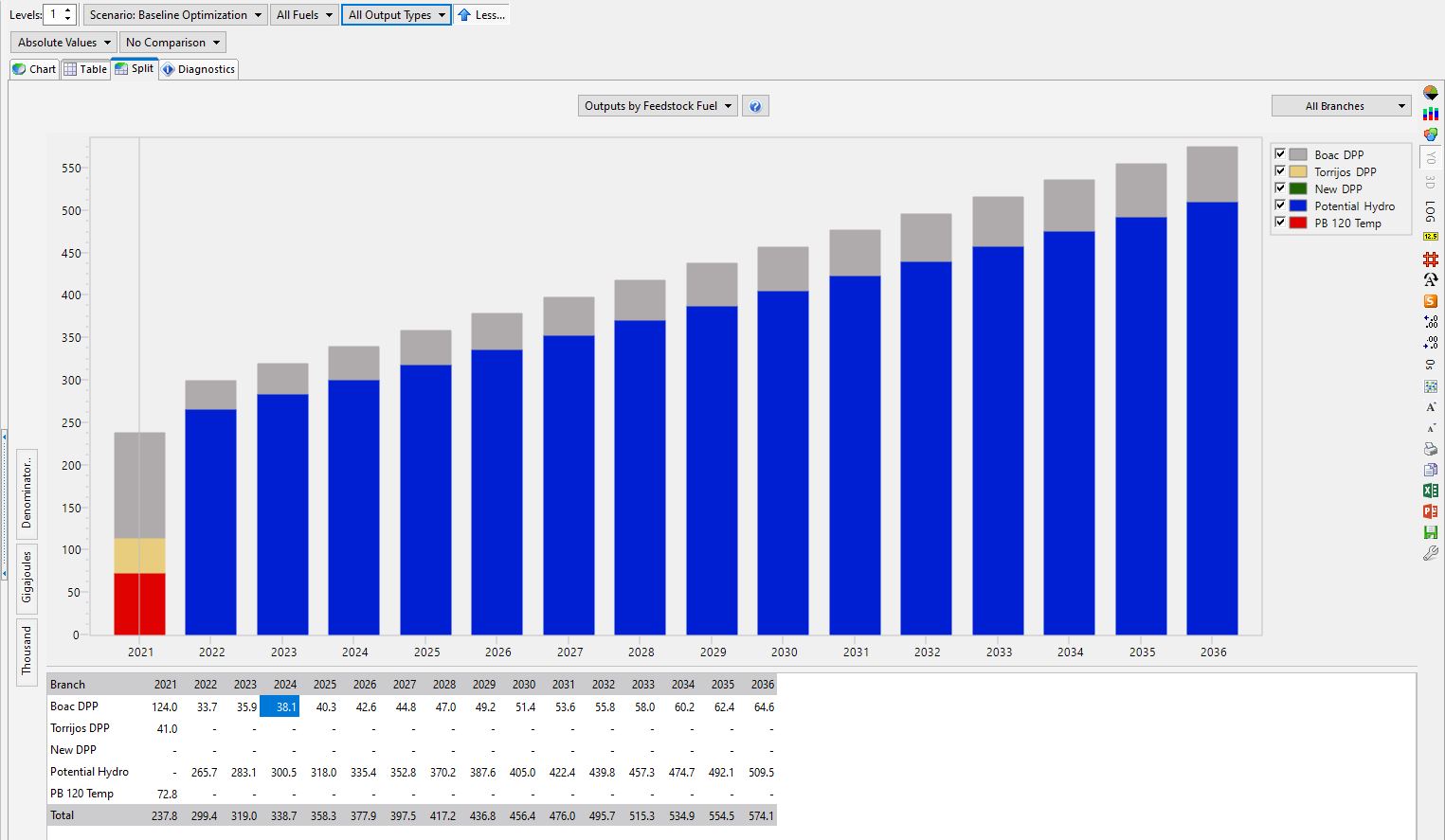

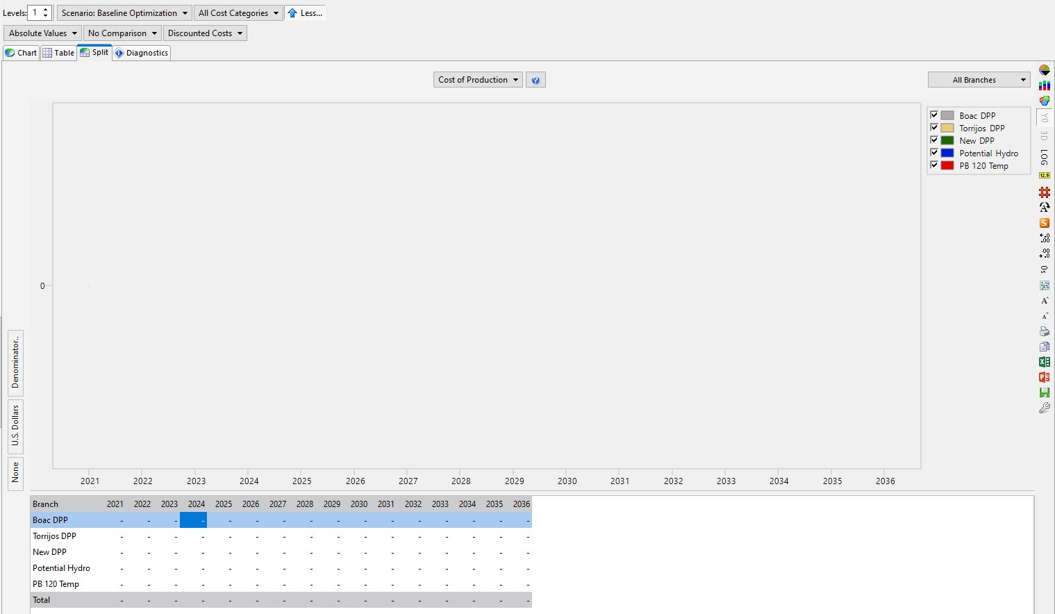

    Hello. For my optimization study on electricity generation, there are no resulting (or displayed) production costs.

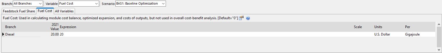

    I have provided the capital, OM (fixed and variable) and fuel costs for all the power plants. I wonder if I forgot something else?
    Please see attached screenshots for reference.
    For your kind assistance please.
  • Muhammad Shahid 4/4/2022
    Assalam o Alikum Anthony
                                              The cost parameters must be in current account so that all scenarios including optimization can pick up the values. I can understand this from your provided data.
