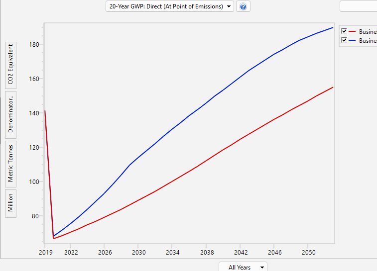

    As I click the result button to see my GHG emission scenario, I come across with warning "Surplus production of 622975018,3 GJ for fuel Electricity sent to export". Should I take into account this warning? If so, How can I fix it ?. Another question is shown in the figure that when ı visualize my GHG emissions for the Business as Usual scenario, I am seeing that there is a sharp decrease from the initial year (2019)to the first modeling year (2020). I think this is related to the surplus problem I mentioned at first. How can I solve this problem?
    Thanks in advance!

    Hi Ugur,
    The sharp decline of the carbon emissions is commonly caused by the sharp decrease of the production. I'd suggest to check the installed-capacity value of the baseyear, and adjust the decrease value of future years. Did you set the value for export? If so, it is advised to adjust the value of export.
