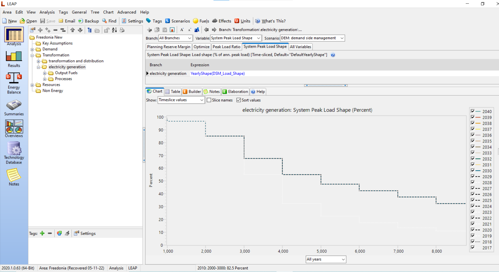

    I have a problem while learning exercise 1.6, I followed the video in Youtube step by step, but my curve(system peak load shape) is not the same as the result in the video, in the video the curve between 2010 and 2040 is linearly interpolated , but in my curve results, 2010 is the value of the base year, and 2011 to 2040 is the value of the DSM scenario, that is to say, there is no linear interpolation between 2010 and 2040. This problem has troubled me a lot.Sincerely looking forward to getting help.
