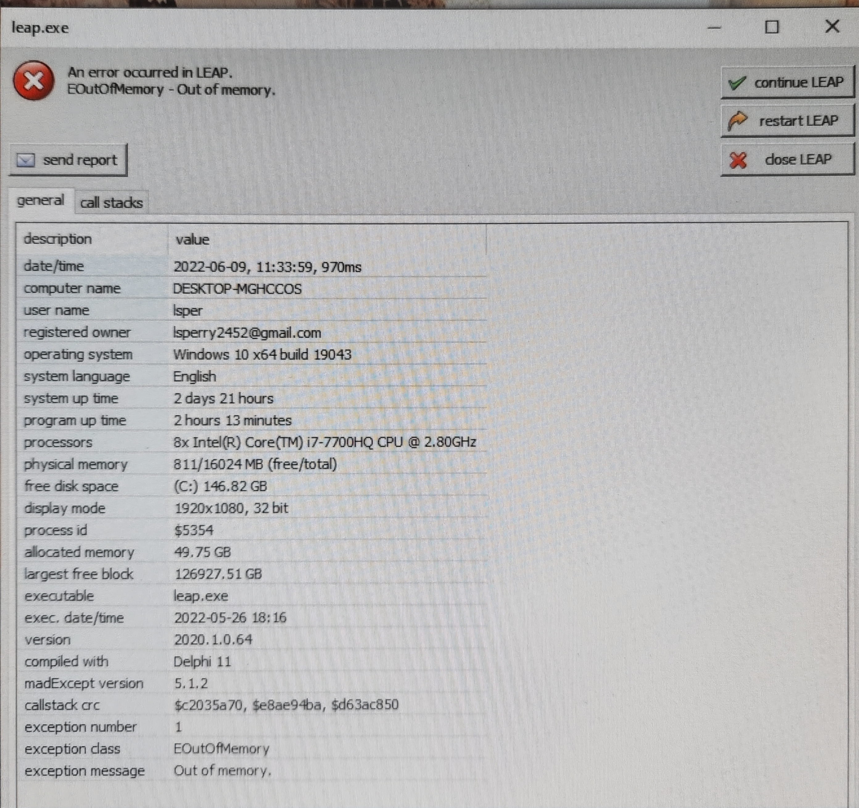

    I am running into an "Out of memory" error when I try to run multiple scenarios for 8 regions. I have no problems when I run multiple scenarios for just one region or when I run one scenario for 8 regions, but I can't seem to run multiple scenarios (even 2) for multiple regions. I have attached an image of the error window. During the crash, there were 65 excel windows open. Is there a known solution to this error for large models?

    Hi Luke
    I’ve seen out of memory issues with the 32-bit version on large models, but I think you are using the 64-bit version (right?), so I’m surprised to see this. If you want to send me your model as a .leap file i can try running it on my pic to see what’s going on..
