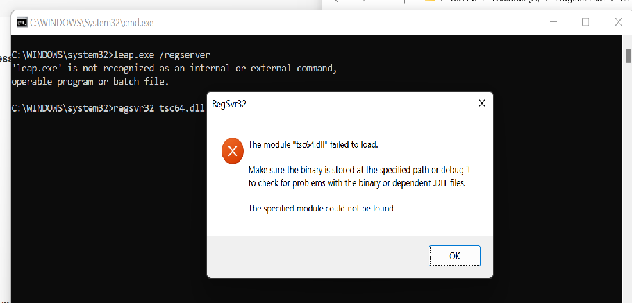

    Dear LEAP team,
    How to activate API in LEAP?
    I tried to activate the API by run registerLEAP.bat in LEAP file but I got notification
  • Maliha Tauqir Butt 6/27/2022
    Save Tsc64.dll (from LEAP folder in your system) in the desktop and then copy it into the document of C:/windows/systems32. Hope this willl help you.
  • Charlie Heaps 7/5/2022
    Registering tsc64.dll from the command line requires that the command line window is opened with full administrative rights.
    From the window start menu, type "command" to search for the Command Prompt app, then right-click on that and select "Run as Administrator".
    You can then select the program files\leap folder and run batch file "registerleap.bat".
