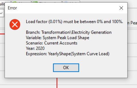

  • Karla Cassandra Borjal 7/21/2022
    I am following the training Exercise # 1: Introduction to LEAP and encountered a similar problem above
    additionally, since I cannot add a new yearly shape I encountered this prompt regarding the Load Factor.
    What should I do? I cannot access the Results view

  • Karla Cassandra Borjal 7/22/2022
    I am using the 2020.1.0.68 update of LEAP,
    the problem still exists.
    Already sent my data set as a .leap file, hope you can help me with my work.
    Thank you!
