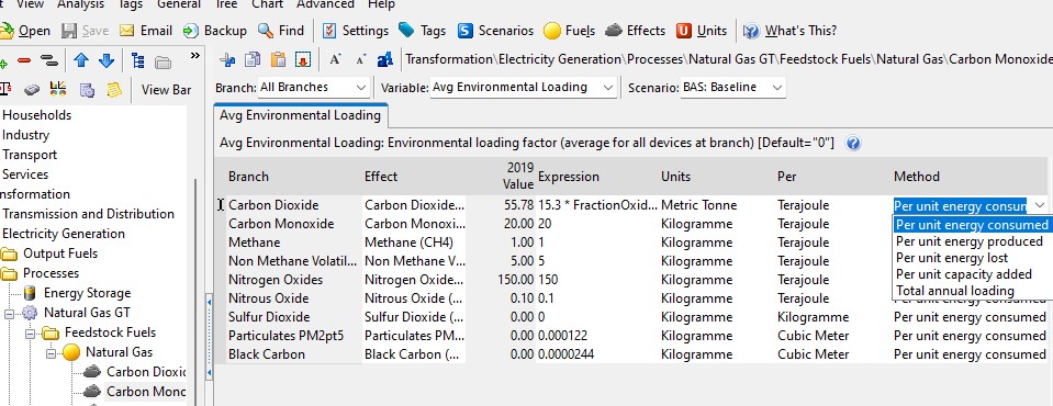

    Emissions are calculated for each technology and, by default, combustion emission factors are specified per unit of energy consumption and are then multiplied by the energy combusted in that technology. LEAP does also support specifying emission factors per unit of energy produced, per unit of energy lost, or as a total. See screenshot below.
    If you are having trouble confirming the calculations please do send me a description of the problem, but I'd suggest carefully checking all the units and scaling factors first.
