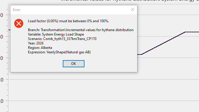

I am getting an error with the new version of LEAP (2020.1.0.71). The error is a load factor error. It worked fine in a previous version so I am not sure what the issue is.
Screenshot attached.

Hi Matt - that should be fixed in the latest version of LEAP (2020.1.74). Sorry for the problems.
