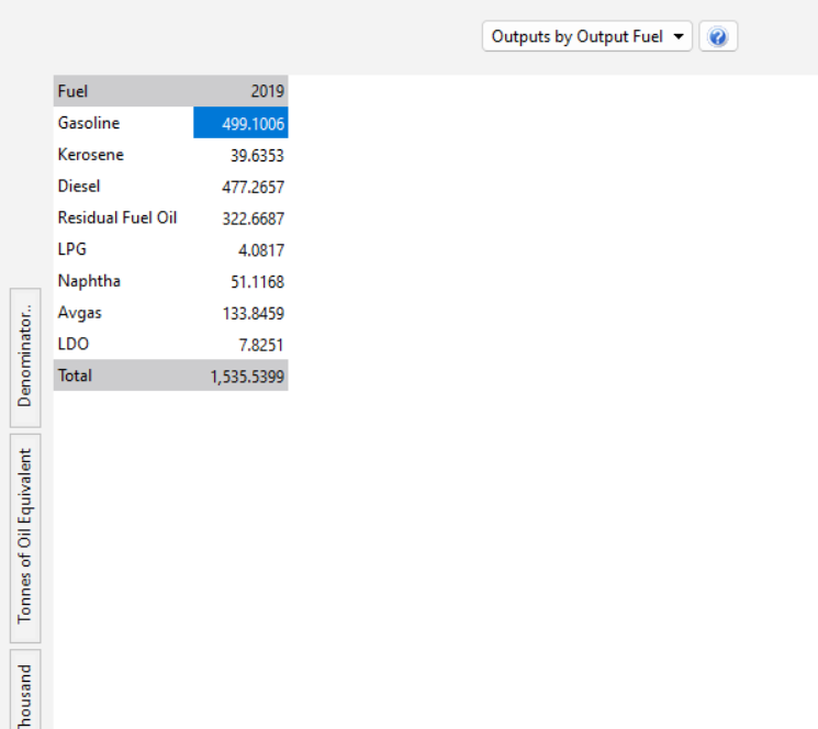

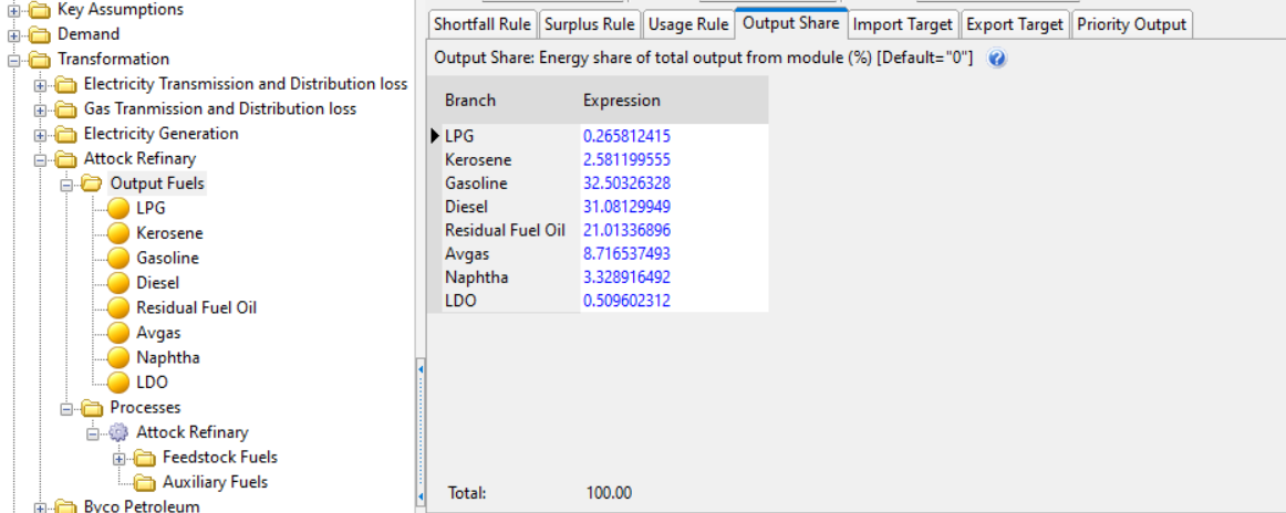

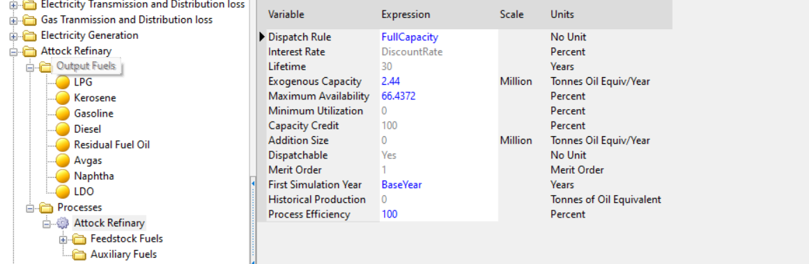

    I am trying to model refineries in the transformation module. The properties of the module are set to capacities, output share, and efficiencies. In input data, the dispatch rule is set to full capacity whereas the output is controlled through maximum availability (Figure-1). To my understanding, this refinery should have produced a total of 1.621 Mln. TOE in accordance with the output shares defined in (Figure-2). But the results (Figure-3) show that the total output produced is instead 1.535 Mln. TOE. Similarly, the output shares are also not being calculated according to the inputs and requirements.
