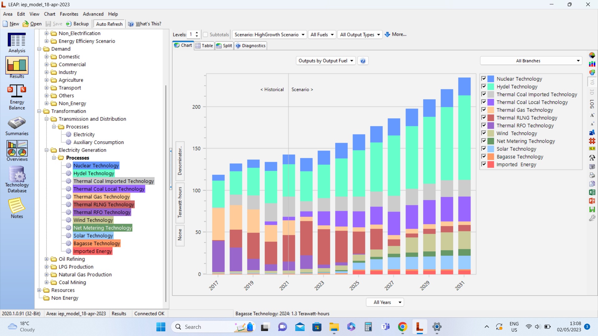

Respected Sir,
I completed LEAP Model for Pakistan. Year 2017 to 2021 is base Year and 2022 is first simulation year. When i run the simulation, the electricity output in 2022 is even less than 2021 whereas demand is continuously increasing.
How it is possible. Please rectify the problem.

Hi Shahid -
This sounds like a calibration issue. Take a look at the result Transformation:Requirements, and especially Transformation:Exports from Module.
Let us know what you find, and if you have further questions,
