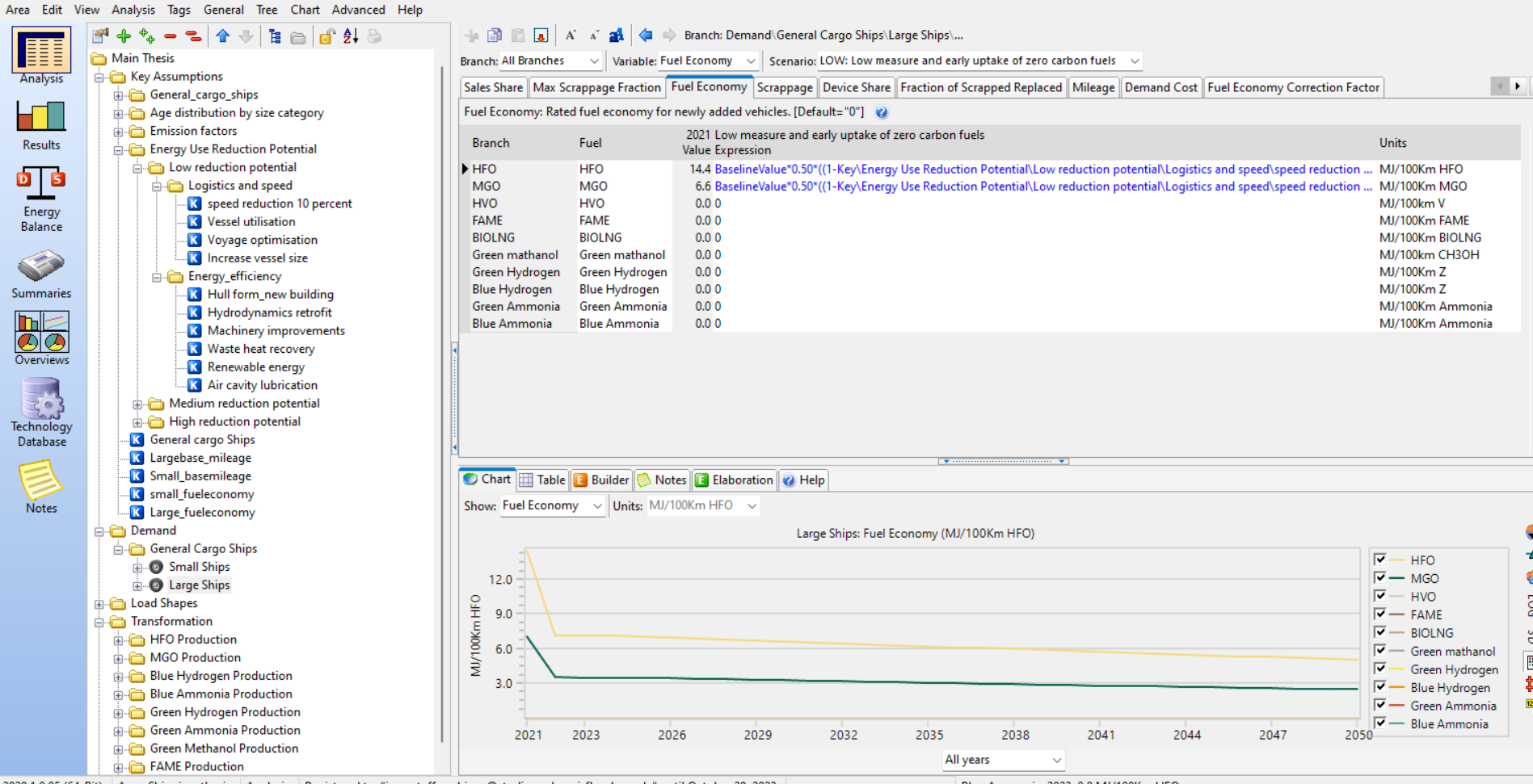

    Dear All,
    I deployed some measures that can help me save fuel consumption. These measures have cost borne to them when utilised. How can I add the cost of these measures in my model. The measures were set as key assumptions and linked to the model. I realised LEAP does not consider the cost of the measures when I attach them to the key assumptions. Any help please.

    Hi Isaac -
    I'm not sure how you tried to connect your Key Assumptions to the model, but I suggest reviewing this help page on social costs in LEAP. Note that cost information must be entered using specific variables in order for it to enter LEAP's social cost accounting.
    https://leap.sei.org/help/Results_Categories/Costs.htm?rhhlterm=costs&rhsyns=%20

    Any help on how the measures can deployed?
