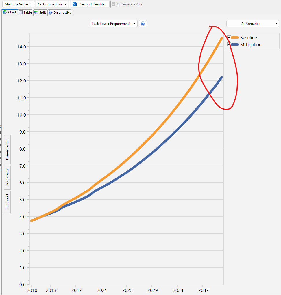

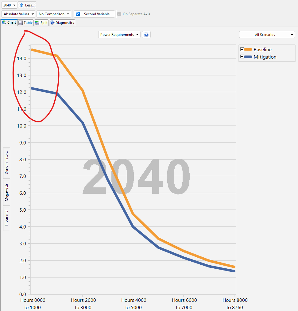

    Hi John - what version of LEAP are you using? It sounds like you may be using an older one. You can get the latest version here (2020.1.98 at time of writing). That may fix a few bugs but it has also renamed those variables.
    This new version has two results variables named power requirements (which varies by time slice) and peak power requirements (which does not). The latter variable simply records the maximum value of the power requirements across all the time slices in any particular year. For example from the Freedonia data set, here are those two variables. Notice that the highest value in the power requirements chart for 2040 (circled), correspond to the peak power requirements for 2040 in the other chart (in each scenario). Notice also that the two charts have different dimensions on their X axes.
