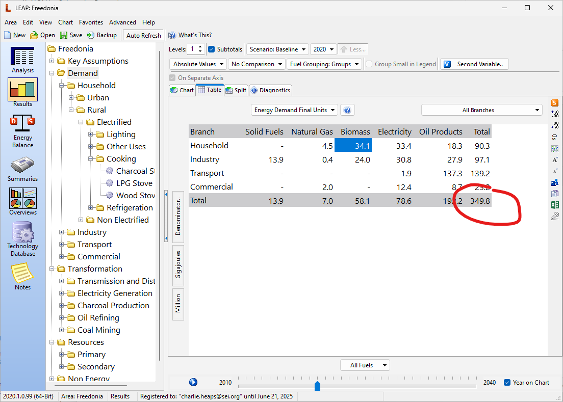

    Energy demand (final units) shows levels of final energy consumption: the energy consumption you have modeled in the demand branches in your LEAP model. The values should be comparable to the section of an energy balance showing final energy consumption. If your model has sectors listed under your high-level demand branch then these will appear as rows in your Energy Balance report and they should be directly comparable to published energy statistics (assuming your model is working OK!)
    As an example, look at the two screenshots below. One shows energy demand in final units in 2020 in a baseline scenario by sector and by fuel category. The other screenshot shows an energy balance for 2020. Notice how the bottom demand section of the energy balance matches the energy demand (final units) report.
