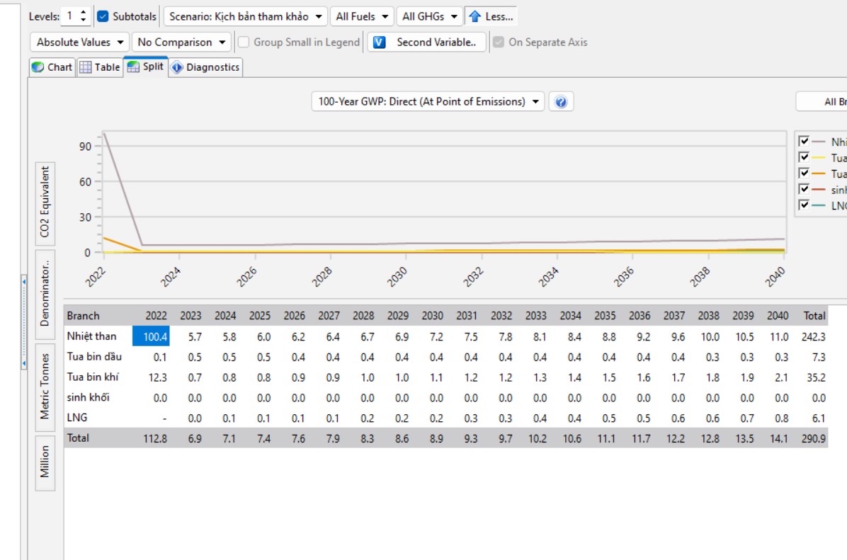

    I have problem to Calculating the specific emissions of the electricity production section. Is there any way to determine the emissions of the electricity production in the model? An Binh Thank you.

    Suggest you check the generation from your power plants to see if they show a similar sudden drop after the base year. Most likely the emissions drop is due to that. Check to see if there is a discrepancy in how plants are dispatched between the base year and first scenario year.
