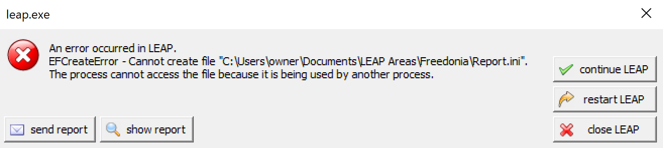

    After successfully installing and try to run the existing Freedonia Model, it brings some error like what i attached here. Any support please?? it happens many times

    There may be a number of reasons for these problems such as: not having sufficient access rights, or running multiple copies of LEAP simultaneously both of which are trying to access the same file.
