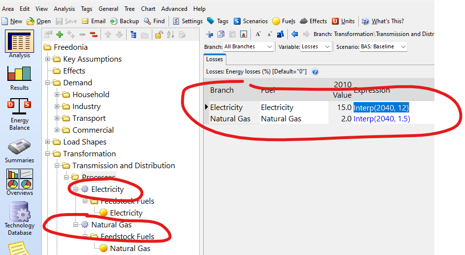

    Hello Dear,
    In the "Transformation" module, you are required to enter loss data following the freedonia example. It says: "Natural gas pipeline losses amount to 2% in 2010" for "Transmission and distribution". I don't quite understand how to capture this natural gas loss since the example is for electricity transmission and distribution. What is the actual loss? Can someone help me to understand so that I can properly collect my data for my work on Côte d'Ivoire (a country in West Africa)?
    Thank you
  • Charlie Heaps 8/7/2023
    Hi Marcel,
    You should be able to enter two processes under the T&D module as shown in the attached screenshot. One deals with electricity losses and one with natural gas losses. Make sure you create this module as a Simple Non Dispatched module, then each process will run independently of the other.
