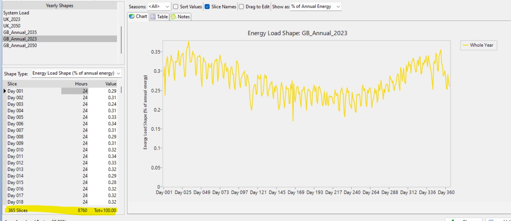

    Just updated LEAP to the newest version. I am seeing the error. I went through the following steps to create the Load Shape:
    1. I have created a TimeSlice with 365 days.
    2. I have imported a full year of hourly data using the "Yearly Shapes" module.
    3. It is created as a% of Annual Energy
    I am getting the error shown in the screenshot. I do not understand why the sum is not 100, since it was generated by LEAP. Do I have to manually correct the values?

    That "NAN" indicates LEAP thinks a value is "Not a Number". so this might indicate there's a problem in the calculations - possibly a bug.
    Could you send your LEAP area so I can take a look at the issue? Please backup the area as a .leap file, then send that, preferably as a link in an email using Dropbox, Google Drive or similar.
    Thanks and sorry for the problem!

    Thanks Charlie. I've shared the file.
