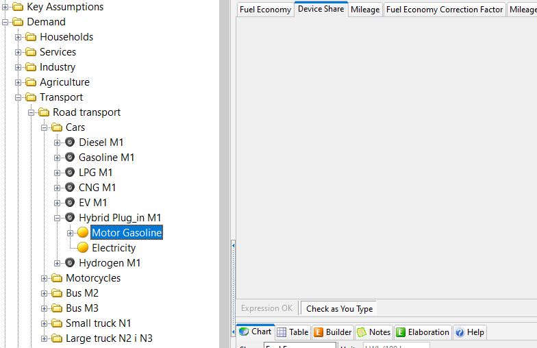

    Hello, I am using the stock turnover model for the transportation sector, and I need to input values in the 'Device Share' tab. However, when I click on that tab, I don't see any input fields (see the image below). What could be the reason for this? I used to be able to input values there before, but now I can't. The LEAP version I am using is: 2020.1.0.103 (64-Bit).
  • Charlie Heaps 9/18/2023
    Have you tried clicking on a branch one level higher or lower in the tree? This does seem like a UI glitch though. If you can send me your LEAP data set as a .leap data file I will try to look at what is going on.

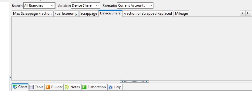

    Hi! I'm noticing the same issue, and it appeared after I recently updated LEAP. I'm working in area developed before, and it seems that device share I defined before is taken into account, and the results are calculated based on that device share inserted before. However, now I'm not able to change device share variable, because it is not visible. I tried you suggestion and clicking around, but it does not help.
  • Charlie Heaps 10/31/2023
    Sorry for the inconvenience. I have seen this glitch a few times but have not yet tracked down the cause. Try opening the branch properties dialog and editing the name (e.g. just add a space to the name) then click OK, save the data set and restart LEAP. This sometimes is enough to force LEAP to regenerate the list of variables visible at each branch.
    If that does not work, please feel free to send your area to me (as a .leap file to leap@sei.org) and I will investigate further.
