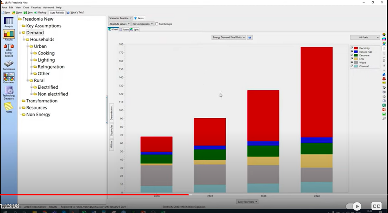

    Iam now learning LEAP through this video https://www.youtube.com/watch?v=cW87lWDABgc
    At the minute 40:48, I see the display on my computer is not the same as the display on the video. You can see this on the screenshot I attached in this message. At my computer, in 2020, 2030 and 2040, the display only shows two colour, while in the video it has more colours
    Can someone tell me what to do?

    It looks like the model you have created in your area "New Freedonia" is different from or missing certain elements included in the model shown in the training video. So that results you see are also different. Suggest you go back to Analysis View and recheck the model you created.
