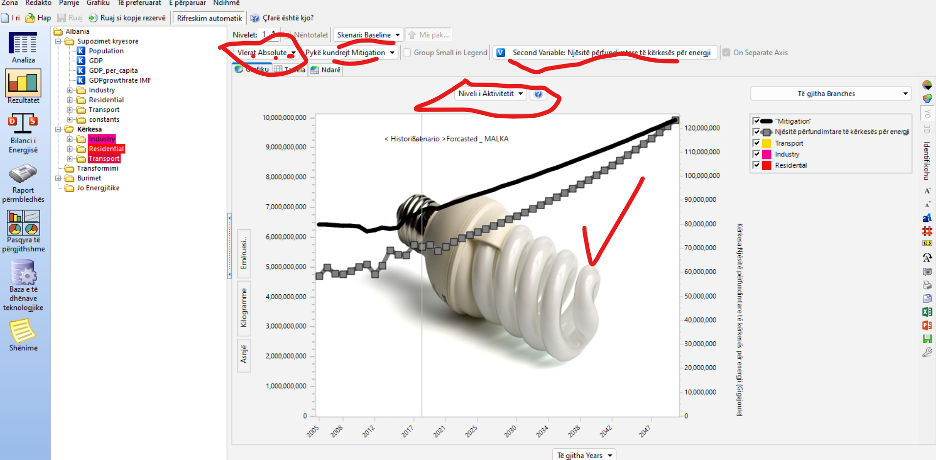

    Hello Dane,
    First of all, you should compare your total activity with respect to a scenario you might have created.
    First step: CLICK ON DEMAND
    Second step: Choose total activity.
    Third step: Go up and select absolute value and after compare two scenarios: for example, baseline scenario with mitigation and choose second variable in the branch you need to check.
    Feel free to contact me if other questions may have
    Regards
