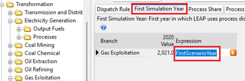

    The issue maybe attributed to the selection in the tab of First Simulation Year. If you want to get the result that you input in the Historical Production, it needs to choose First Scenario Year in the tab of First Simulation Year. Meanwhile, the First Scenario Year should be set after the base year. It can be set in General-Settings-Years. The attachment is for your reference.
    Best regards,
