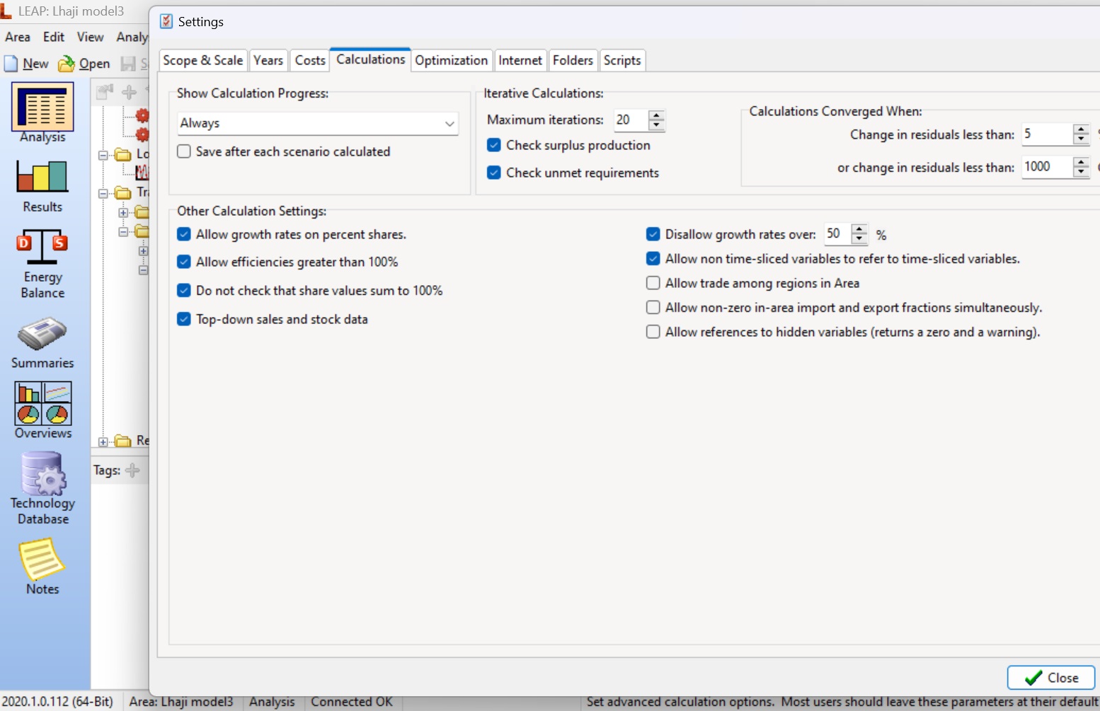

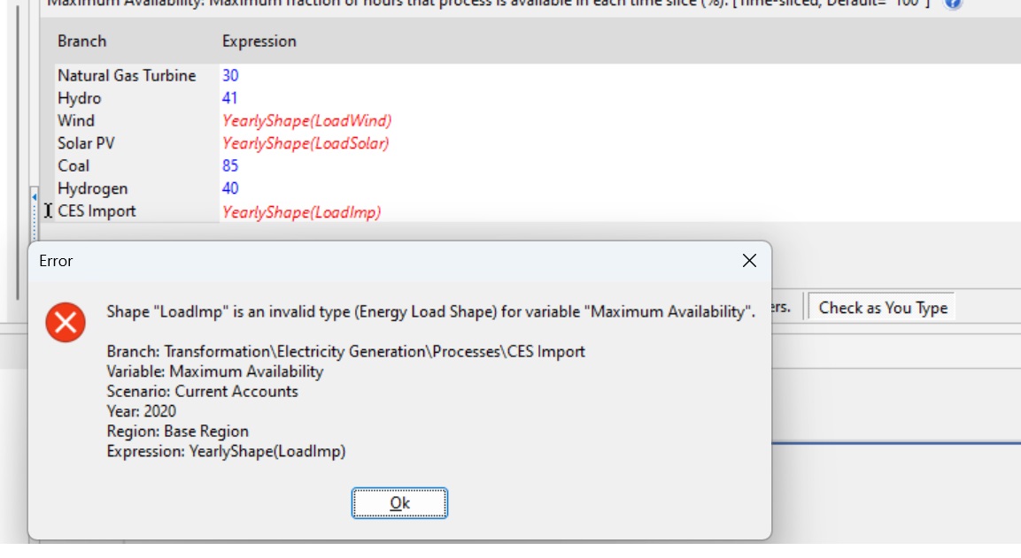

    Someone please help me. I have created LoadShapes in LEAP with data collected from solar and wind sources and when importing these LoadShapes into LEAP I get the following error. I tried to configure it in Settings, but there is no such configuration on my LEAP. How to solve this problem. Also, I would be very grateful if you could share your experience using Dispach pattern.

    In order to enter a yearly shape into the Maximum Availability variable, you must configure the yearly shape to be of type "Availability Shape" when you create it using LEAP's Yearly Shapes screen.
