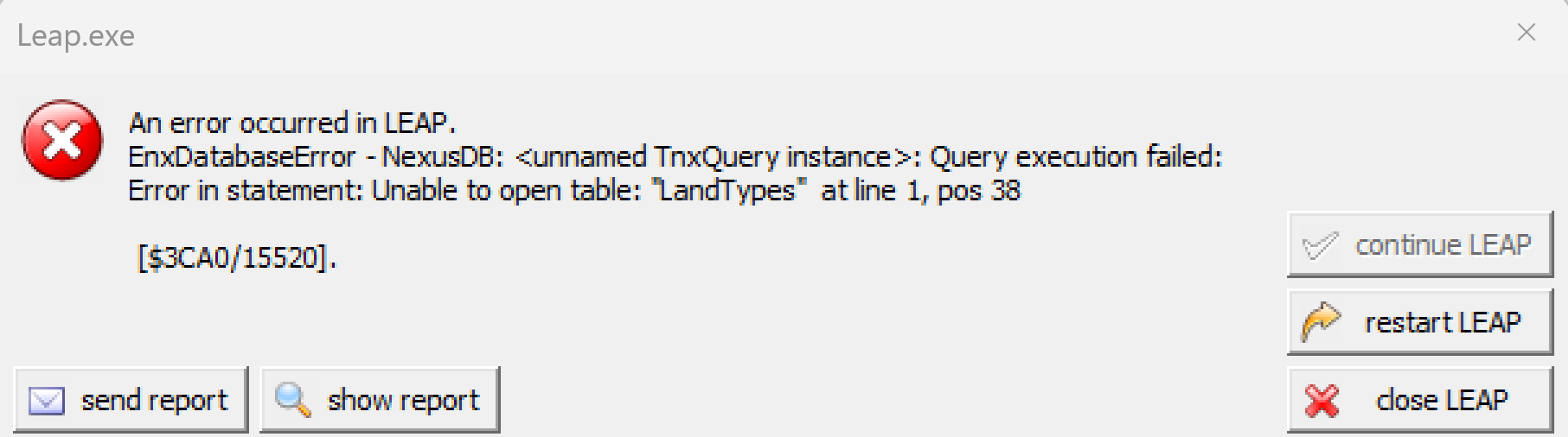

Error in Statement: Unable to open the table: "LandTypes" at Line 1, pos 38
Usman Ahmad 5/23/2024
Dear colleagues,
Has anyone encountered with the error (attached as a snapshot) while using the LEAP latest version? If you got any remedies, please share it here (step-wise) so everyone having the same issue would be able to rectify it.
Thanks.
Charlie Heaps 8/16/2024
Please update to the latest version of LEAP (2024.1.0.7). I believe it should fix this error.
