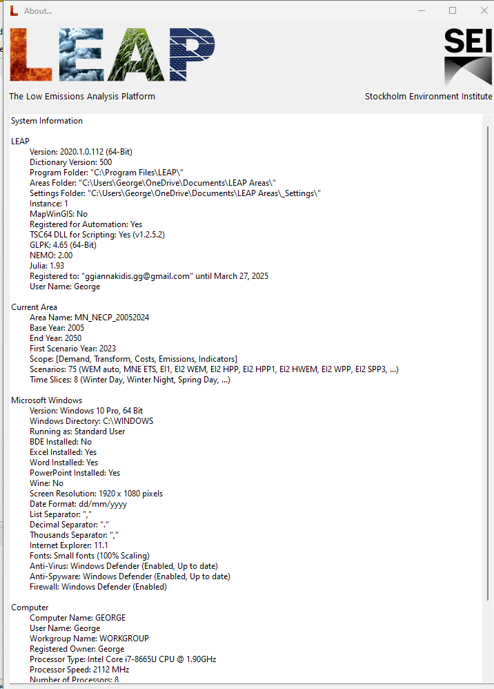

    Dear all,
    although NEMO was working fine for some time, suddenly I started getting the message "Julia plugin for CbC not found" and the same for SQLite, GLPK, JuMP when I start LEAP.
    I have uninstalled and re-installed LEAP and NEMO but the problem remains.
    I am attaching the Help/About screen.
    Thanks for the support,
    George
  • Jason Veysey 7/19/2024
    Hi, George -
    One other idea here - in LEAP, try selecting Settings -> Optimization -> Reset NEMO.  Let us know if that helps.
    Jason

  • Georgios Giannakidis 7/26/2024
    Hi Jason,
    when I do resetNEMO I get the same set of popups:
    Julia plugin for Cbc not found,
    Julia plugin for SQLite not found,
    Julia plugin for GLPK not found,
    Julia plugin for JuMP not found,
    Any ideas?
    Thanks
  • Silvia Ulloa 8/14/2024
    Hi Georgios,
    Are you using the latest versions of LEAP and NEMO? If so, let us know if the problem still persists. Thanks!
