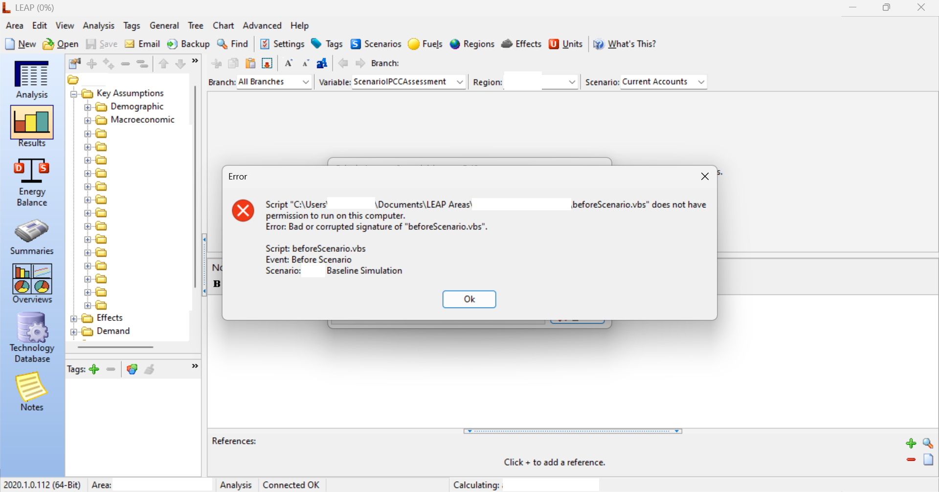

    I am trying to run Results on an existing LEAP file, and I got many pop-up errors: "script ........vbs does not have permission to run on this computer".
    I have tried to run LEAP as Administrator, but the message still occurred.
    Thank you for your support.

    You can set permissions for what scripts are allowed to run on your computer by going to the the Settings: Scripts screen.  For your protection from malware, by default LEAP will only run scripts that are signed by SEI.
    In your particular case be aware that if you edit a signed script you will then need again to sign it before it can be run.
