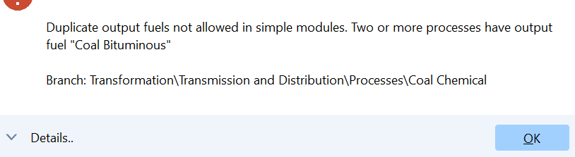

    When I use the new version of LEAP 2024.1.0.1 to run the model, an error occurs. I indicates duplicate output fuels are not allowed in simple models. But this model ran successfully in previous version. May I ask anyone who could help me figure out this issue? Thank you.

    I think that would nave been a problem even in LEAP2020, but it was not properly catching that and reporting it.  I'm afraid the only solution is to rework your model.

    Looking at that screenshot I can see you have losses that are actually dependent on each other (distribution, transport, production) so it would not be good to include them all in a single module as they are happening in order rather than in parallel to each other. I would recommend making three modules dealing with those three types of losses: distribution, transport, production.

    I have tried to rework my template. I created a single module for electricity losses under Transmission and Distribution Branches. I am not getting the error anymore. Seems this has solved the issue.
