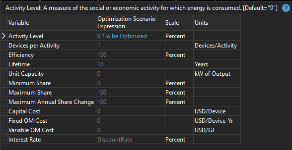

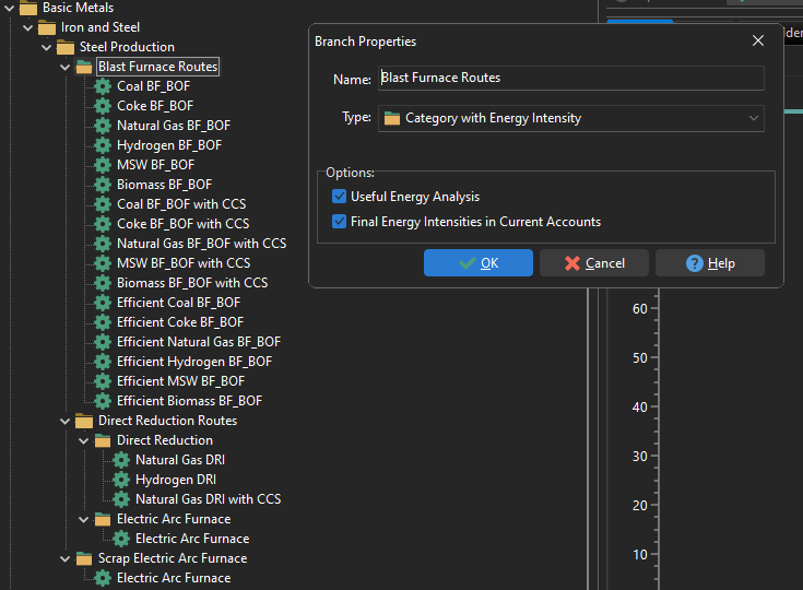

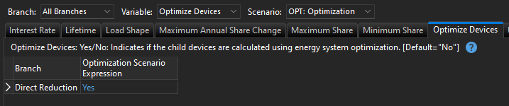

    Yes, you can make an optimization scenario through "Category with Energy Intensity." Don’t forget to check the Useful Energy Intensity and Final Energy Intensities in the Current Account, as shown in the picture I attached. However, after trying the same process you want to follow, I found that the consequence is the need to input useful energy, efficiency, and all of the cost variables for each technology, this is not easy. And also you may have a lot of variation if you're aiming to exercise the fuel share for BOF. Perhaps we can collaborate to benefit each other by sharing assumptions/catalogs for each technology to complete this task.
