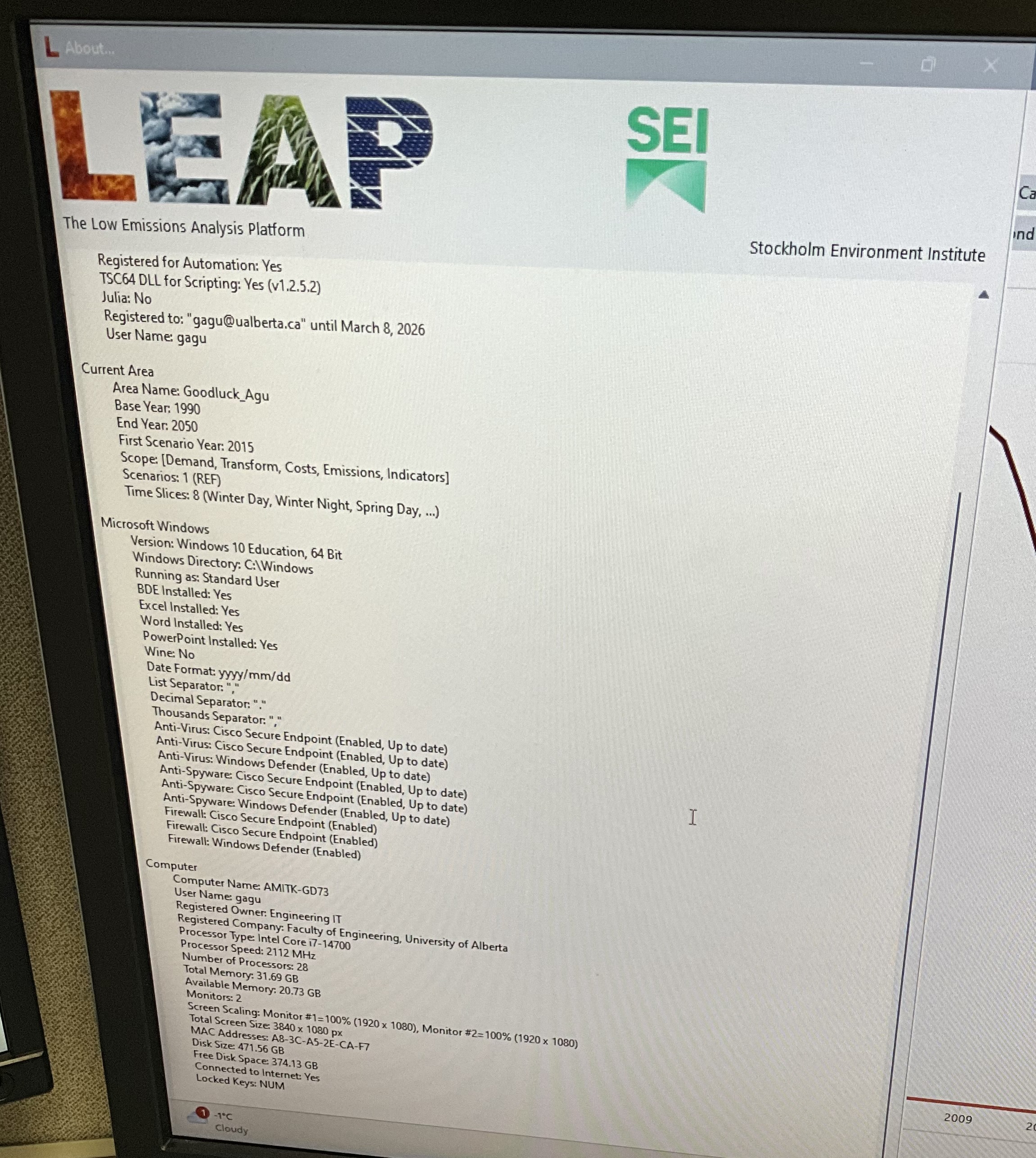

  • Goodluck Agu 10/22/2024
    Hi Charlie,
    Thank you and apologies for the delayed response. Please find attached images showing the contents of the Help: About screen.
    Goodluck
