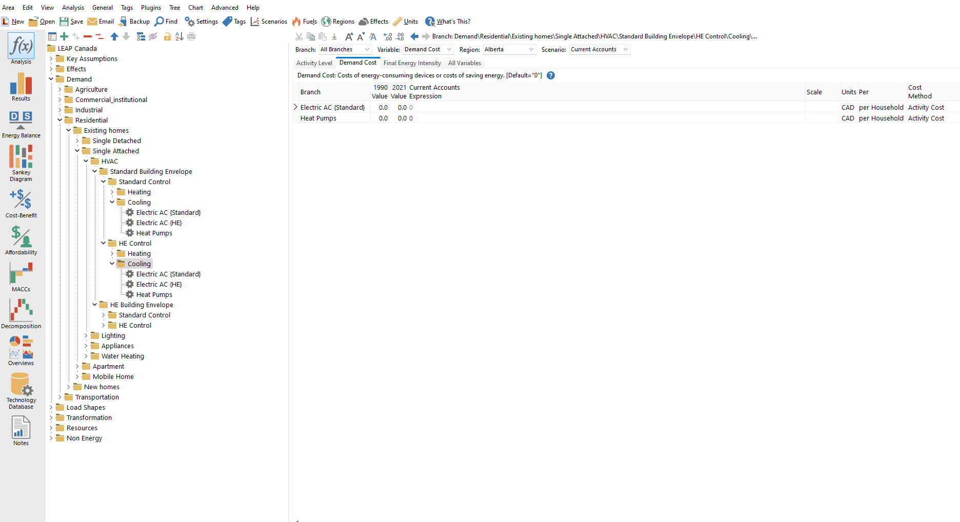

    In Analysis View, when attempting to access Device Cost, certain branches are missing the variable (please see image - there should be three branches under Demand Cost but there are only two). This is happening for many branches and requires me to manually edit properties or save the area to make it reappear. I use the API to update many branches, and I find this occurs after attempting to update with the API. It seems to only happen for Device Cost variable. Any advice is appreciated.
    Matt

    Sorry Matt - this sounds like a big. Will try to fix soon.
