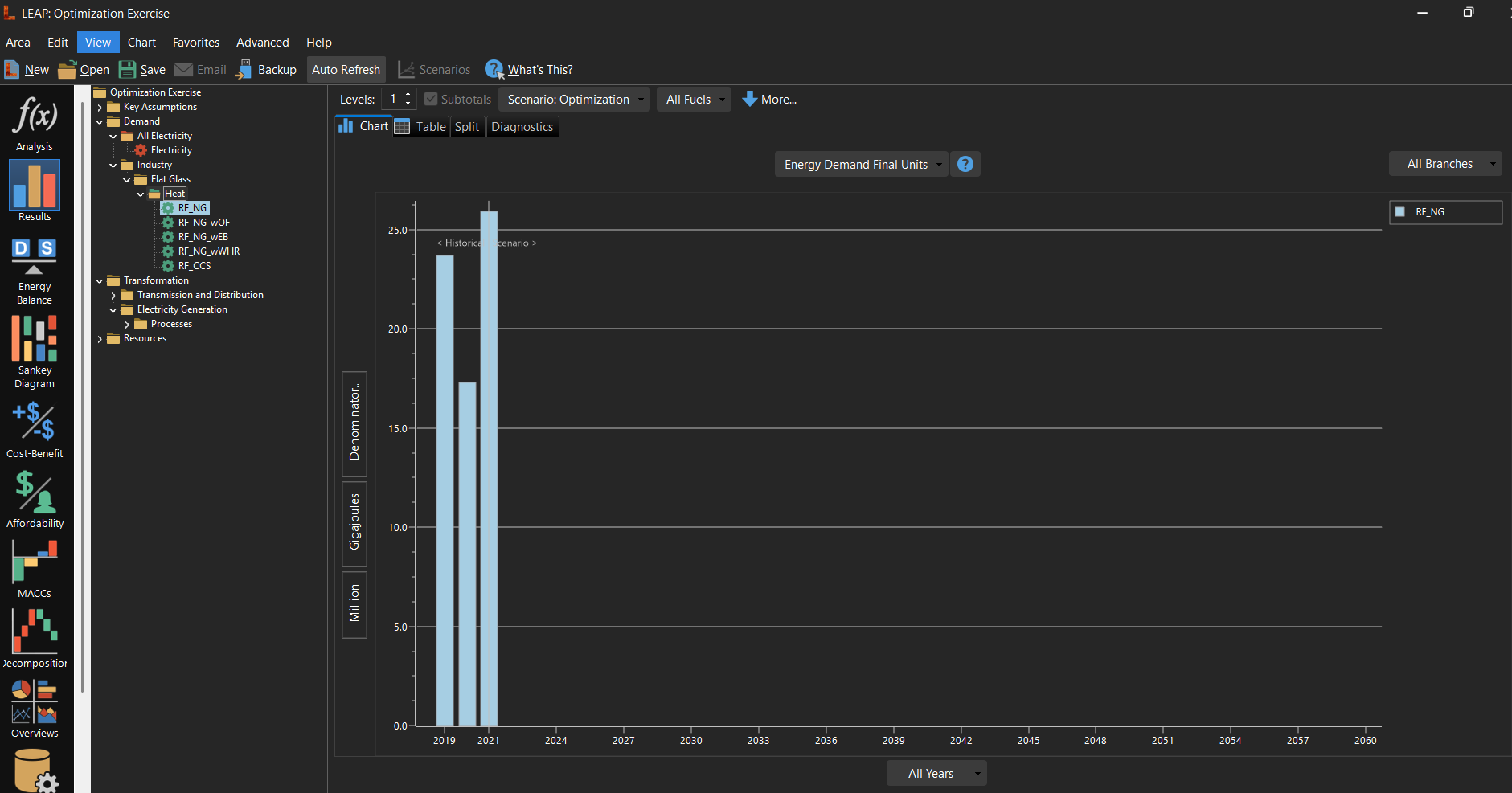

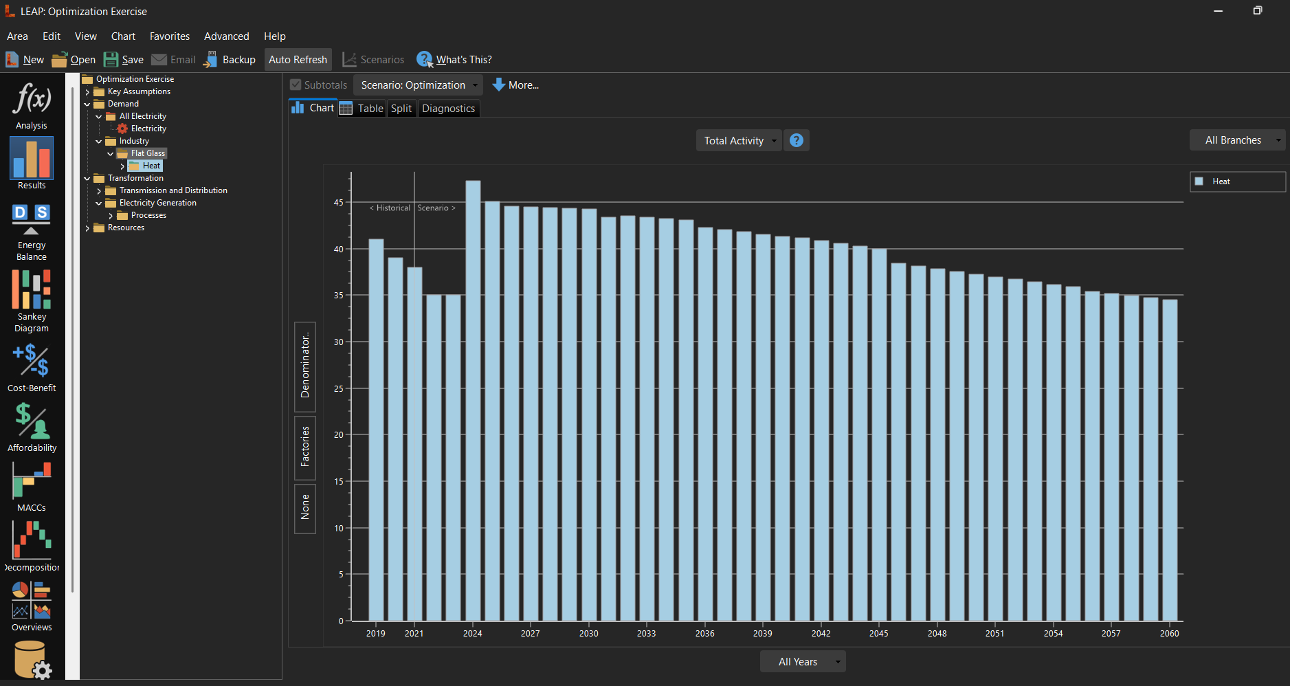

    I am working on optimizing an industrial process using LEAP and have just adjusted the activity level from "per metric tonnage production" to "factory unit" to ensure the compatibility of 'devices per activity' data requirement information for the optimization setup. I have also set the activity level value from the base year to the end year accordingly.
    However, when running the optimization, the results do not show any "energy need" or process technology option competition to fulfill the activity level needs. Could you help clarify why this might be happening? Am I missing a necessary configuration or additional settings required for the optimization to recognize the new activity level properly?
