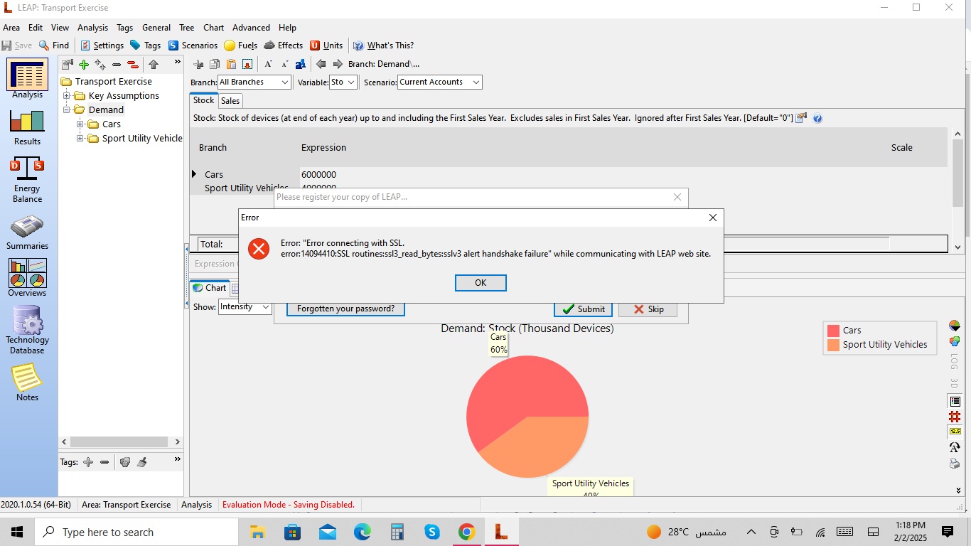

    Sir,
          My Previous Laptop is lost. Now i want to Register LEAP on another Laptop but the attached message is appearing. The Registration Code is disappeared and password of LEAP Login page is not working
    Please help me in this regard
  • Charlie Heaps 2/3/2025
    Hi Muhammad,
    You seem to be using LEAP2020. That version uses an older communication protocol that can no longer connect to the LEAP web site. Please updated to LEAP2024.
