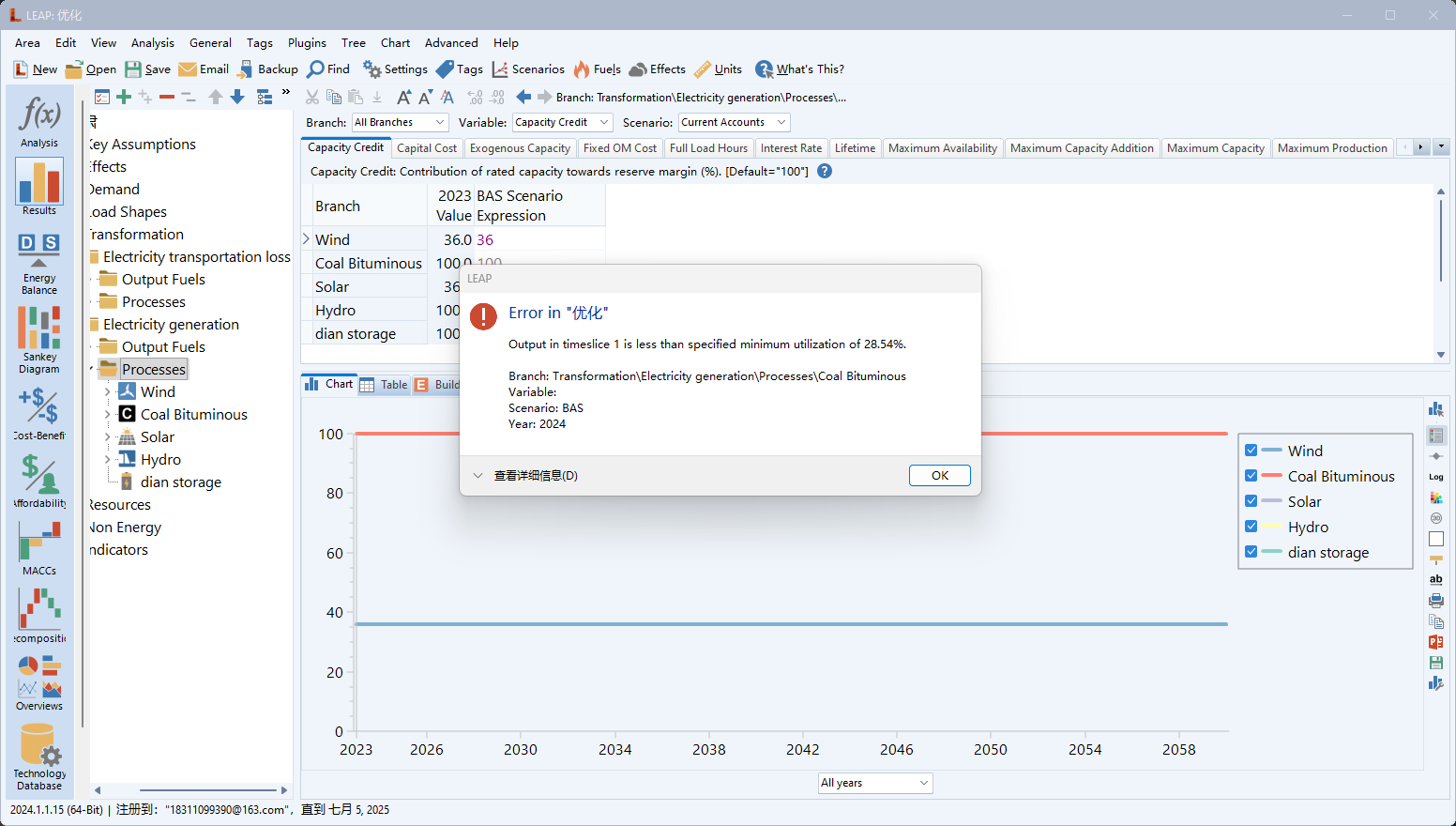

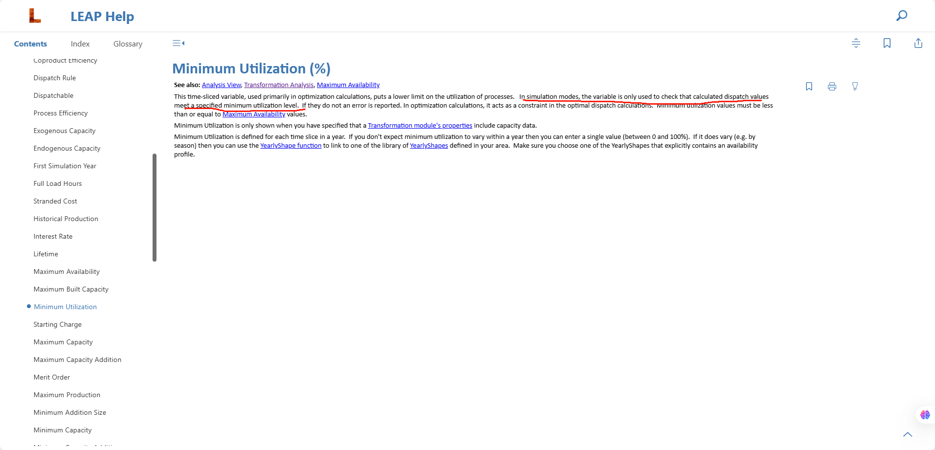

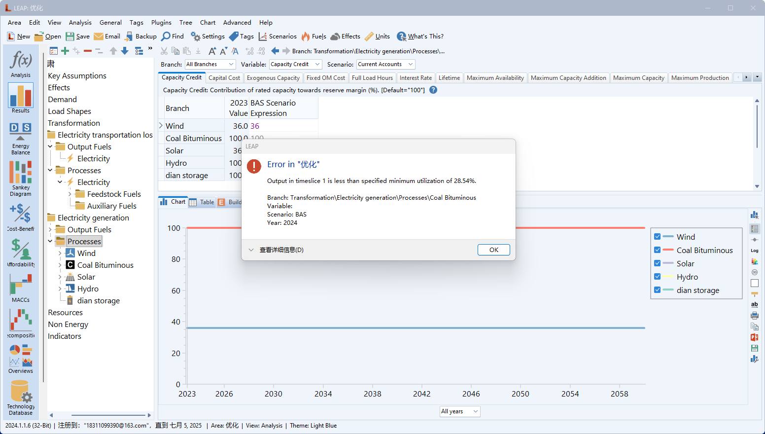

    I have set the minimum utilization during the optimization process, but I am getting an error that the thermal power output cannot meet the minimum utilization. But as far as I know, the error is only reported in simulation mode, when I reduce the thermal minimum utilization it can be run and wind and water are generating at maximum power, so why the optimization mode won't satisfy the thermal minimum utilization limit first.

    Thanks for the reply. I've updated to the latest version, but I'm still having the same problem. I don't know what's wrong. Can I trouble you to check it out?
