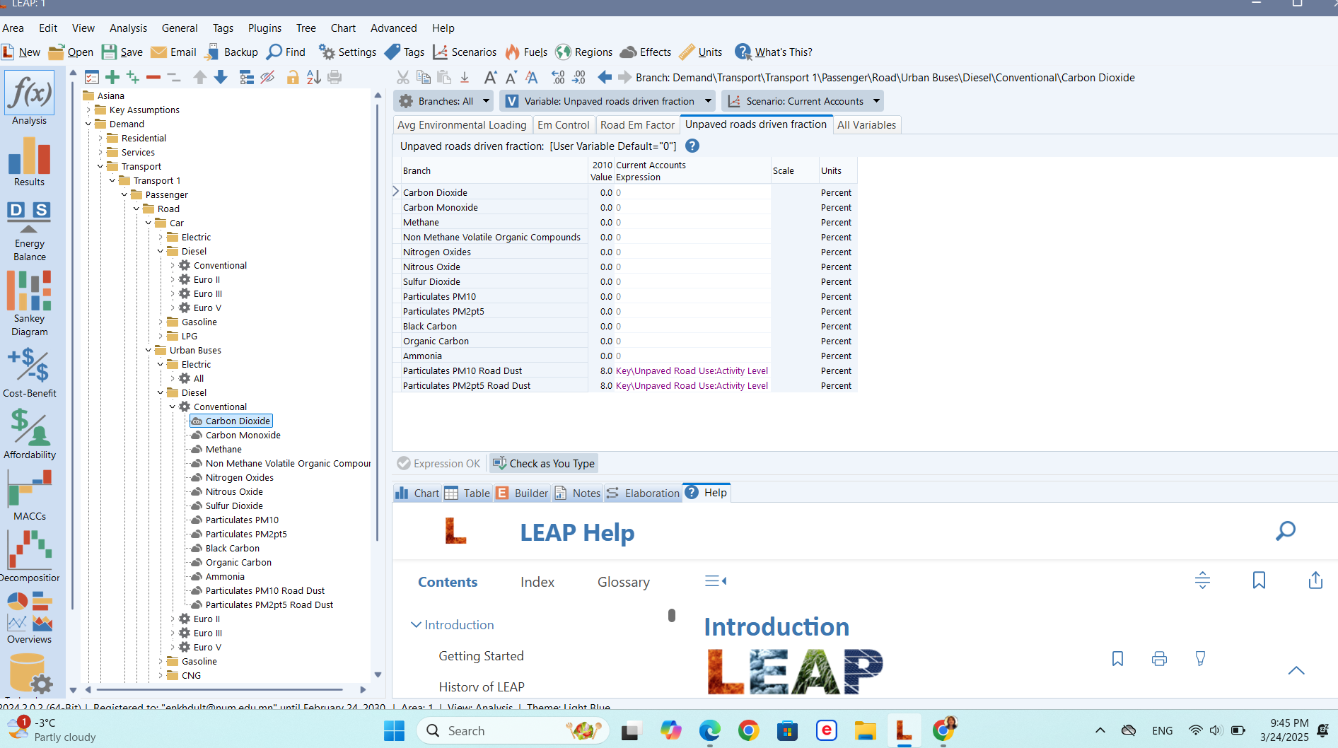

    Hello, I am a new learner. I am currently trying to model GHG emissions for the transport sector. Is this section necessary for the final calculation, and is there a ready dataset or do I need to fill it in? If I need to fill it out manually, where do I find these, do I use the value generated from the Road em factor section? A reply would be deeply appreciated. Thanks in advance

    Dear Enkhdul,
    As far as I can see, you have adopted the Asiana model.
    If you are talking about the "Unpaved Roads Driven Section" parameter specifically, then yes, they need to be updated, given you have the data.
    Otherwise, if you are only concerned with emissions due to the combustion of fuel in vehicles only, you can leave it as it is, the only impact being on the estimation of pollutants due to road dust.
