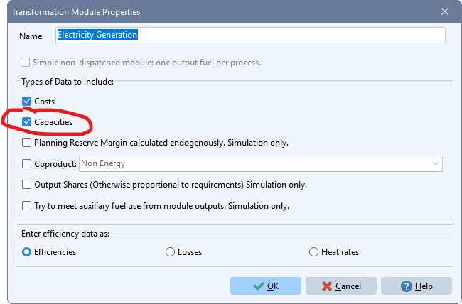

    You can separately specify whether a Transformation module will include capacity data. Do that by editing the Transformation module properties screen shown here. If you do include capacity data, then you can also specify a Planning Reserve Margin (at the module branch, and then use either the Exogenous Capacity or Endogenous Capacity variables to specify capacity additions and retirements. LEAP will automatically add new plants to try and maintain the specified reserve margin based on the processes you list in the endogenous capacity screen. Note that you can also specify a variable called Capacity Credit, which determines how much each process counts toward the planning reserve margin. Baseload plants typically have a capacity credit of 100% but variable renewable processes may be much less.
