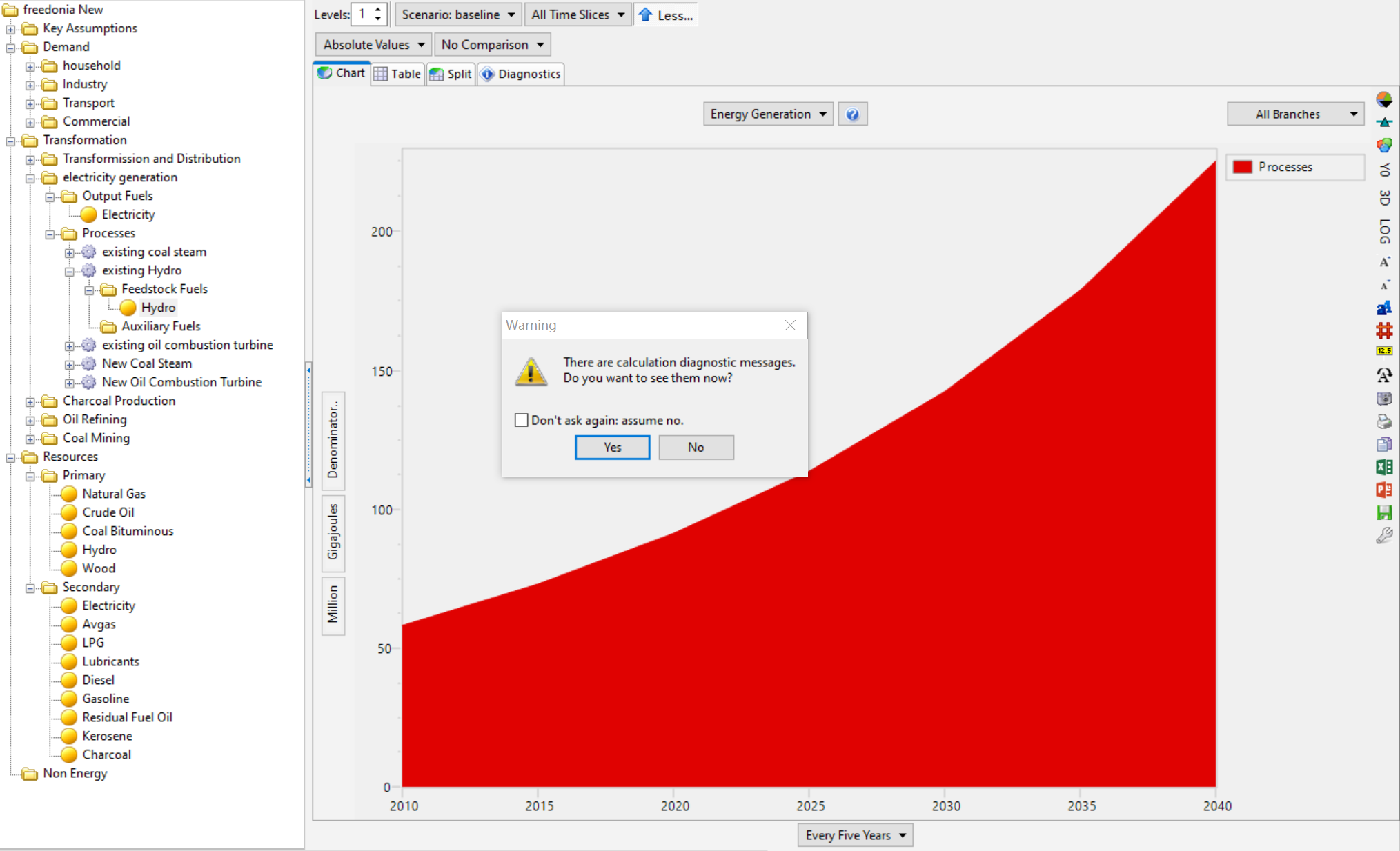

    I encountered some questions when using LEAP. I followed YouTube for step-by-step practice operations. When I finished the data entry of exercise 3 and prepared for the result view, the screen showed the following error.
    I conducted a self-examination, but did not get the cause of the problem.
    Can you help me analyze the cause of the error, thank you!

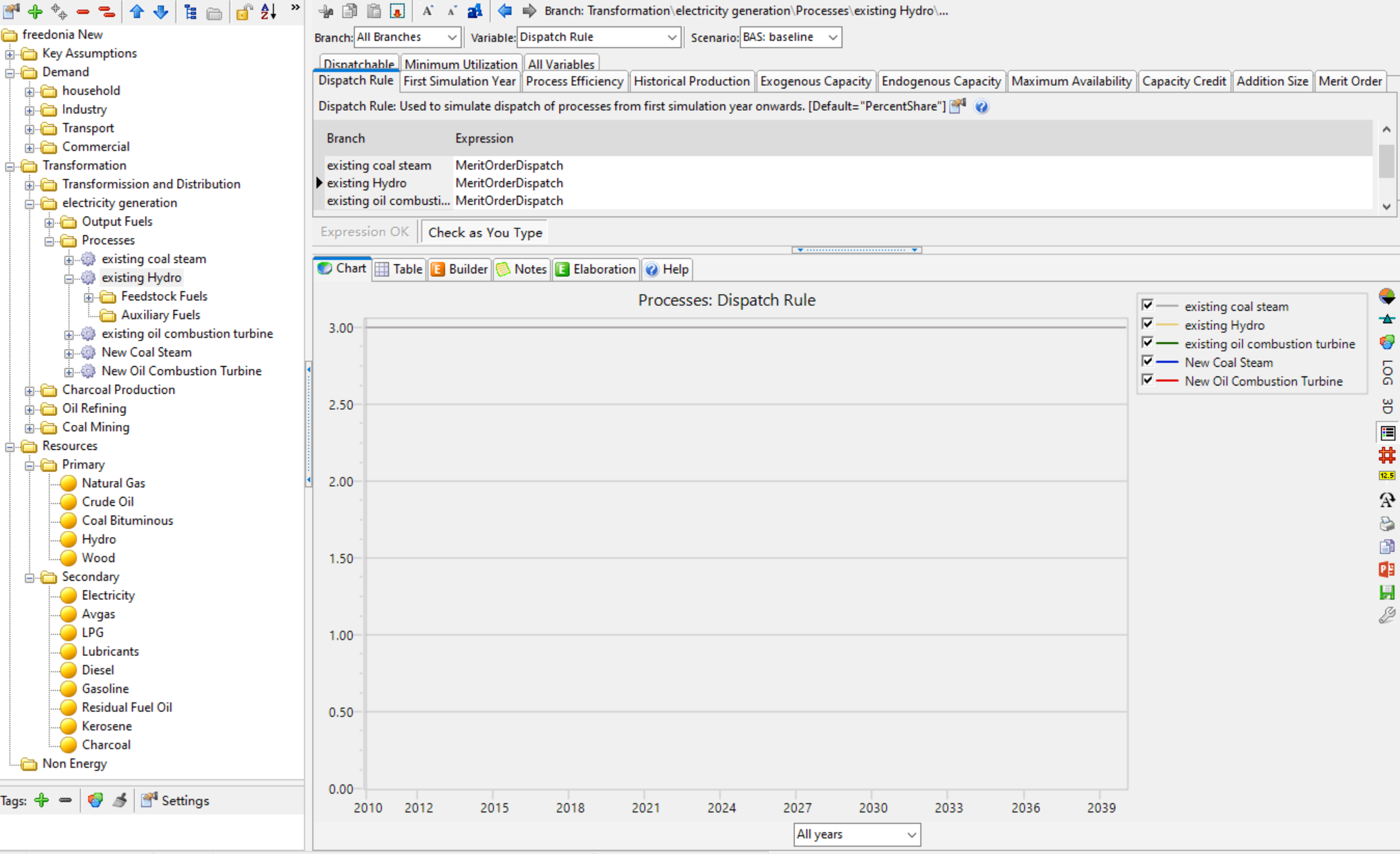

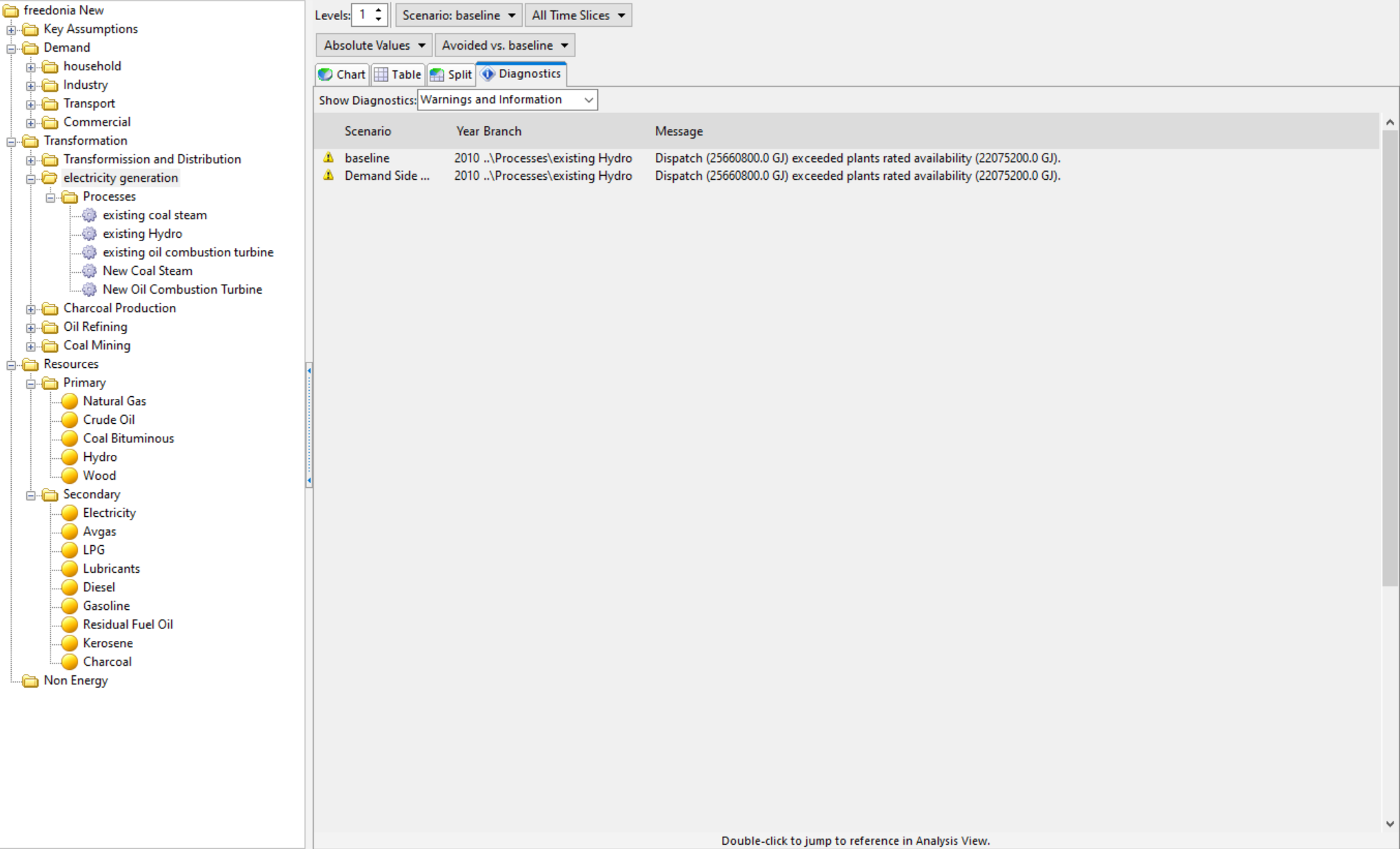

    This warning most commonly occurs in a base year or a year before the FirstSimulationYear. It occurs when the data you entered for Historical Production exceeds the amount that could possibly be dispatched based on the data you entered for the Exogenous and Endogenous Capacity variables and the Maximum Availability variable. Check the data you entered for all of these variables, particularly in the Current Accounts data set and pay special attention to the scaling factors and units used to specify the data.
