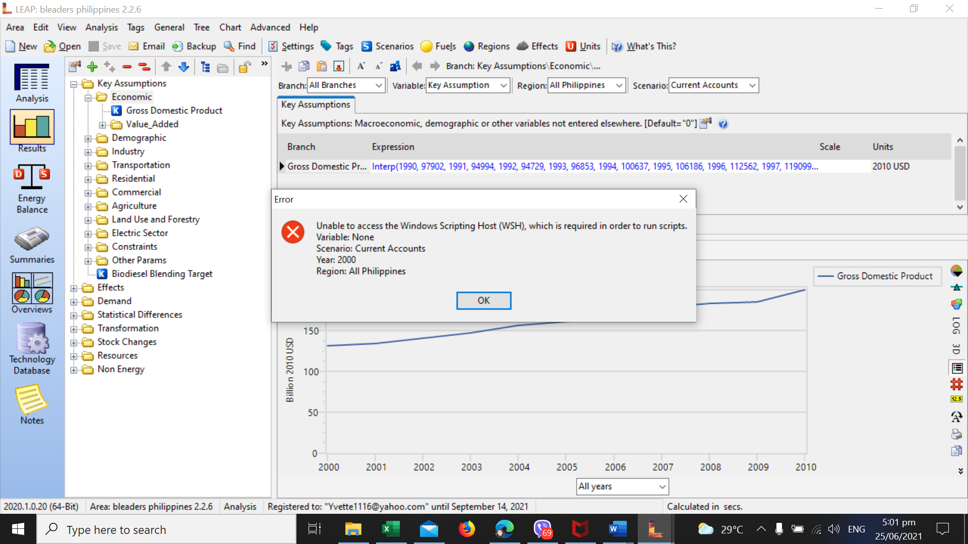

    Hi, I have some problem in getting leap result from an old database,  A message that says"Unable to access the Window Scripting Host WSH, which is required in order to run scripts: appears.
    How do I fixed it.
    Thank you very much

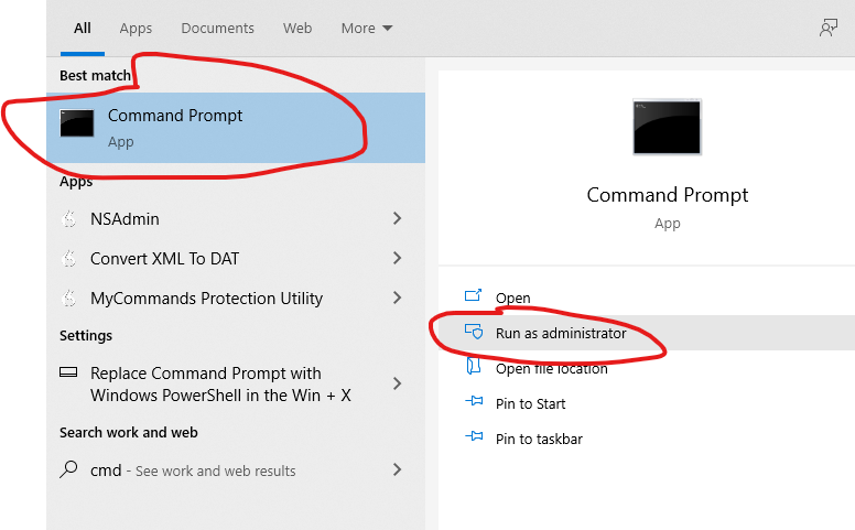

    2. Open a Windows Command Prompt by clicking on the Windows Start button, and typing CMD (See "CMD" screenshot), then open a Command Prompt with Administrator privileges. NB: You must have admin rights to register LEAP. If you don't have admin rights, contact your system administrator.

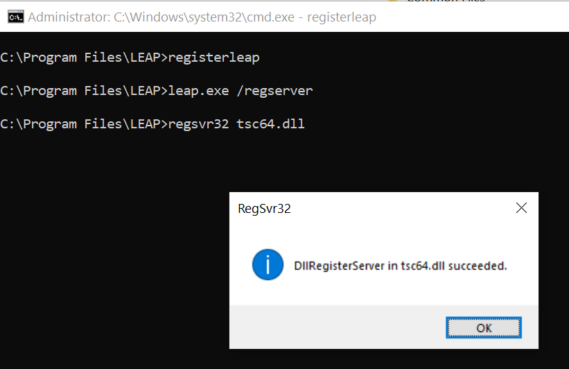

    4. Once you have changed the active directory, run the registerleap.bat batch file by entering the command:
    RegisterLEAP.BAT

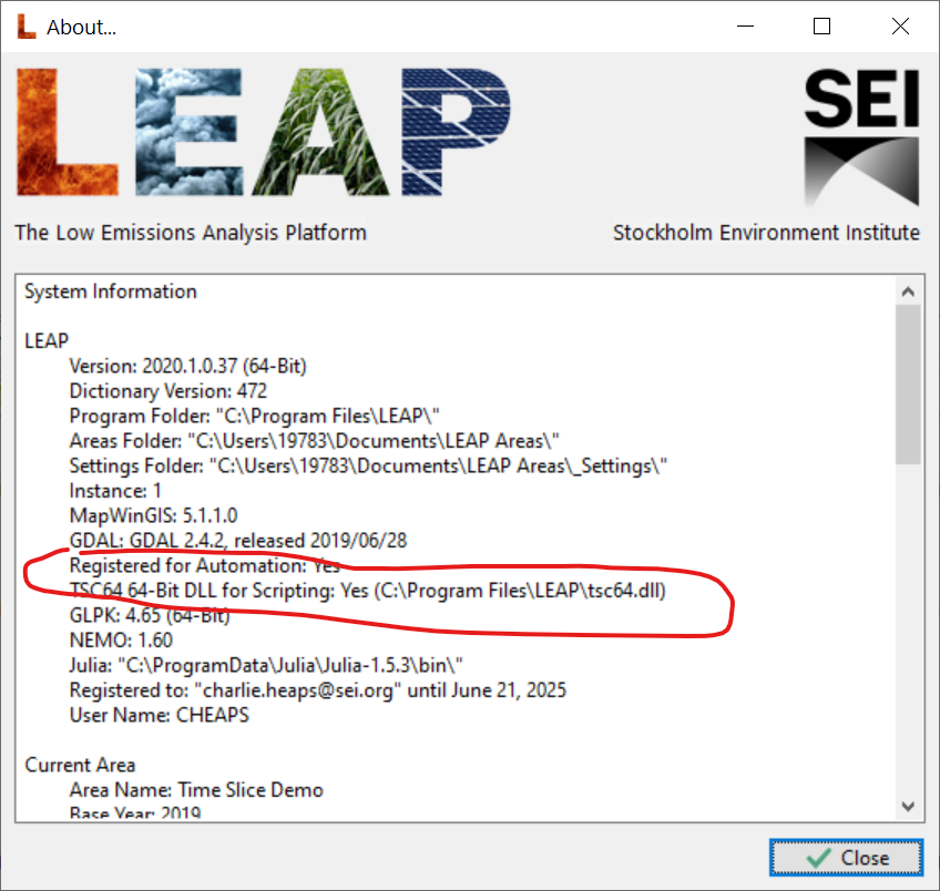

    If all goes well, you should see a screen like the one attached (Prompt). You can then rerun LEAP. Go to the Help: About LEAP screen to see if LEAP is properly registered (see About screenshot).
