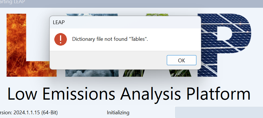

    Hi all,
    I encounter an issue that LEAP softwear can not be opened. When I clicked the LEAP icon, it pops up an error message, showing "Dictionary file not found Tables". Does anyone know how to figure out this issue? Your assistance would be appreciated.

  • Charlie Heaps 2/3/2025
    Hi Liya - a few people seem to be seeing this error after updating to 2024.1.1.5.  Sorry for the inconvenience.
    Could you please try exiting LEAP then delete the LEAP Areas\_Settings\_DefaultNX  and LEAP Areas\_Settings\_DictionmaryNX folders.  Then try running LEAP again.
    Please let me know what happens.

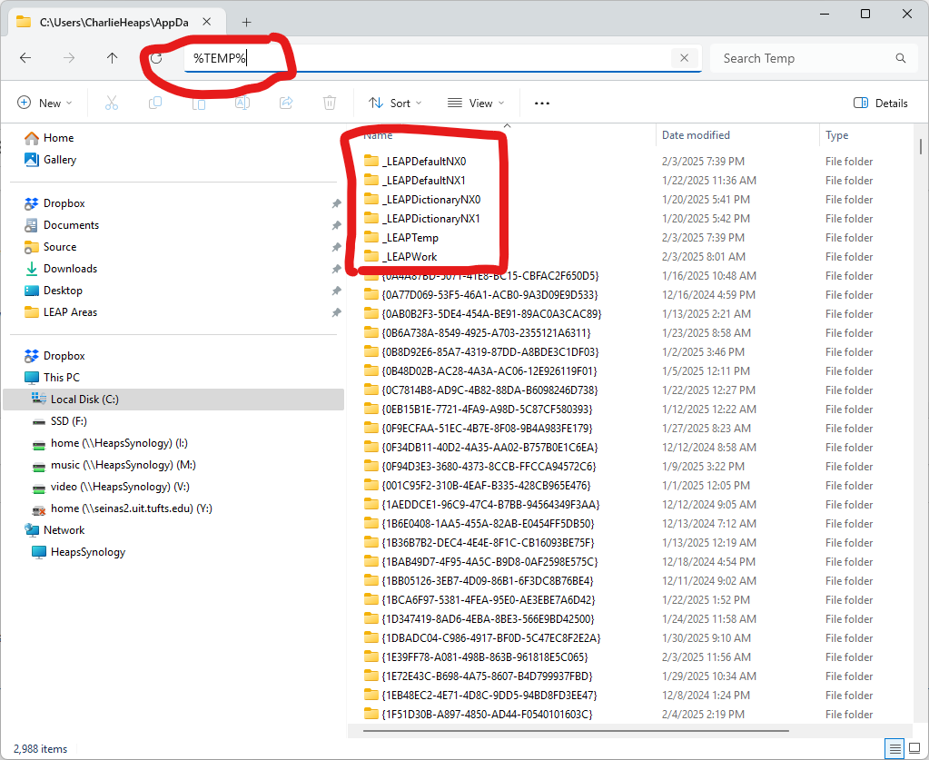

    As a temporary workaround, please try the following:
    1. Exit all running copies of LEAP.
    2. Open Windows Explorer. You can do that by pressing the Windows+E on the keyboard.
    3. In Windows Explorer navigate to the windows temporary folder. You can do that by entering %Temp% in the topmost address bar.
    4. You should then see a number of folders all with names beginning "_LEAP". Delete those folders. They will be recreated next time you run LEAP.
    5. Try running LEAP again.
    See the screenshot below by way of example.
    Please let me know if this helps. In the meantime I will look at how to prevent this happening.
  • Liya Cai 2/4/2025
    Hi Charlie,
    I appreciate your guidance and remote assistance. The issue has been resolved successfully.
