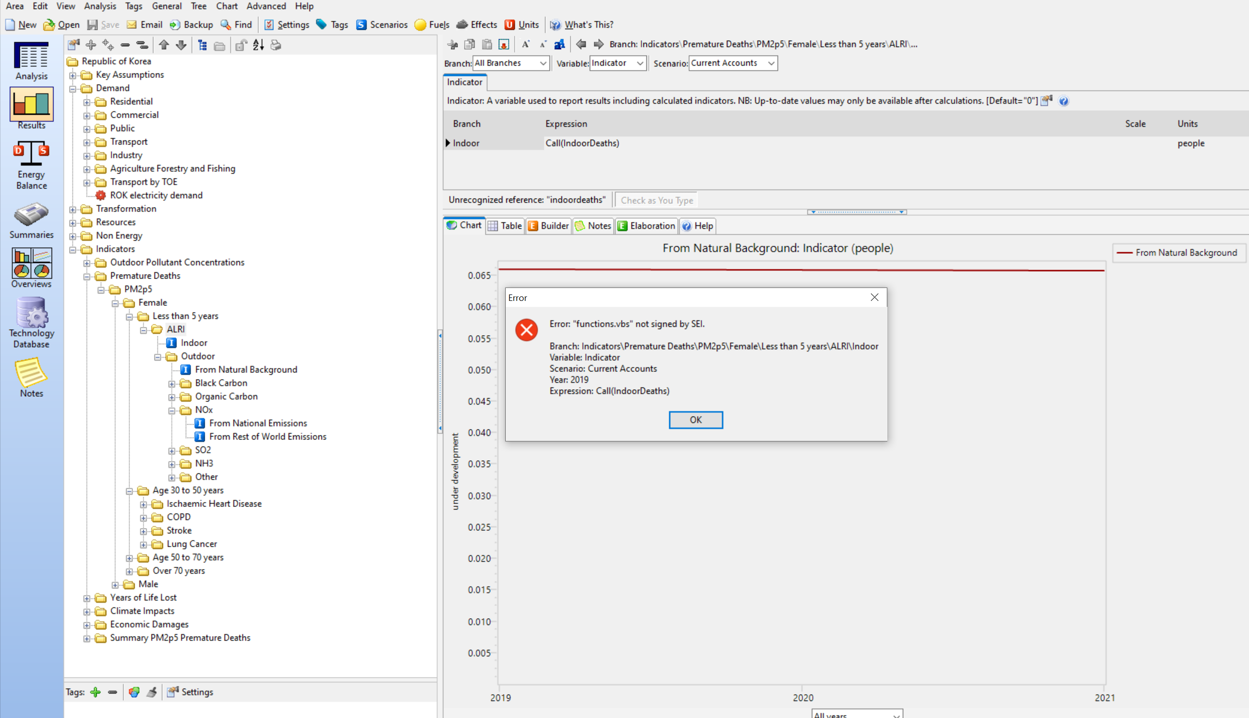

    After updating to the latest version of LEAP, my LEAP-IBC model for South Korea will not run and the following error message appears: Error: "functions.vbs" not signed by SEI.

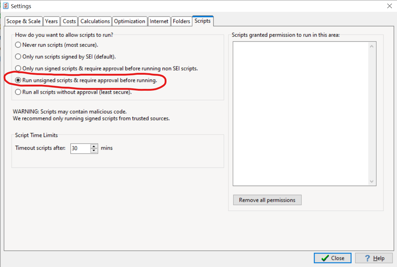

  • Charlie Heaps 3/25/2021
    The new version of LEAP (2020.1.28) is stricter about script security and by default now only want to run scripts signed by SEI. The intention is to help provide protection against malware, viruses, etc. The scripts in any existing models won't be signed. To work around this, you can go to the Settings: Scripts screen and choose a less strict policy. I would recommend going with "Run unsigned scripts and require approval before running" as shown here.
