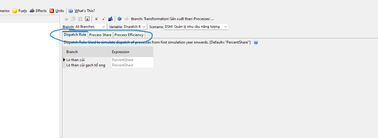

    I am experiencing an issue with the process of creating a technology box in transformation. I am unable to turn on the Transformation Module properties again. Do you have any ideas, or should I delete and recreate it?

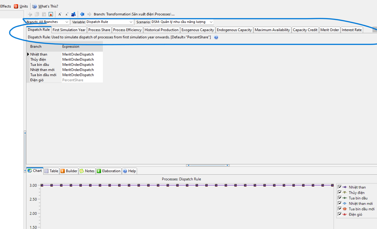

    You should be able to access the Module Properties screen by right-clicking on a module in the tree in Analysis View and selecting "properties". Once you have created a module as either a simple or detailed module, I'm afraid you cannot change that setting. You would need to delete the module and recreate it. Sorry for this inconvenience. See screenshot as an example.
