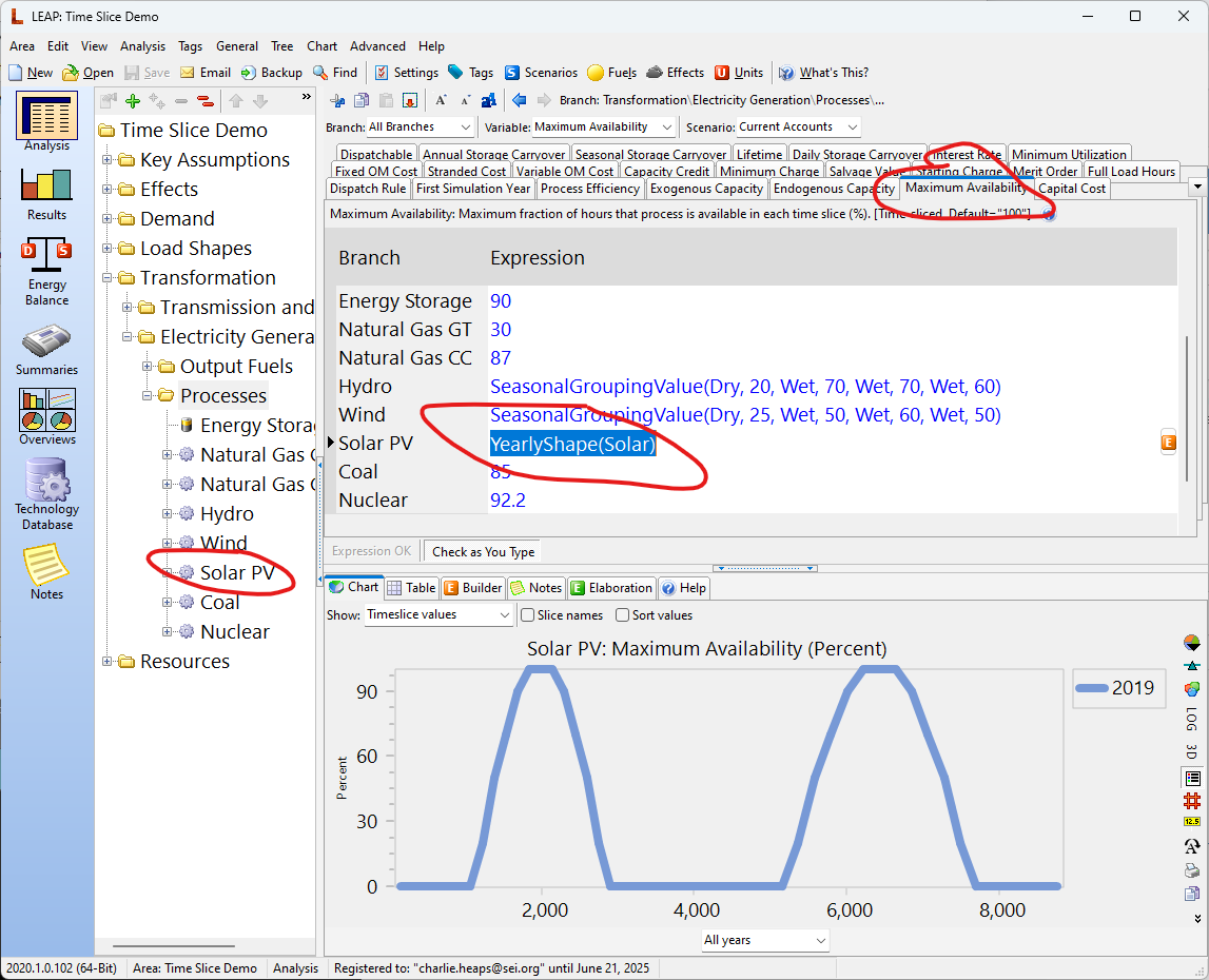

    I would like to ask about the dispatch for the solar energy by using Optimization.
    Could you suggest how to dispatch the solar energy for day and night?
    Regards
    Zu
  • Charlie Heaps 8/21/2023

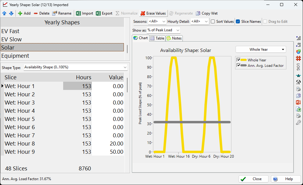

    I suggest you set up time slices in your LEAP area that include hourly information (e.g. 4 seasons x 24 hours).  You can do that in the General: Time Slices screen.
    You can then specify a load shape in the General: Yearly Shapes screen that describes the availability of your solar power plants and you can then use that in the Maximum Availability variable (specified for each Transformation process) to control when solar is dispatched. See the attached screens from LEAP showing the Yearly Shapes screen and the Maximum Availability variable.
